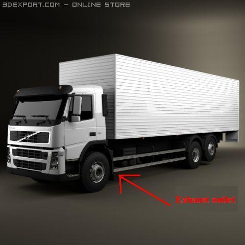

    I have a problem. I work as a local distribution truck driver, but for some reason i keep getting a headache from an unidentified smell that enters the cabin. The smell is best described as somewhat similar of burned plastics. I have tried changning truc to another one of the same model and brand, to see if the problem was with the truck, but it stays in the other car aswell.
    The trucks in question is volvo FM, relativitely new, built around 2005. The problem occurs mostly in city traffic, and i have long suspected that it is related to exhaust gases entering the cabin. None of the cars have exhaust leaks though (checked in the repair shop), however the exhaust outlet is situated quite close to the cabin:
    The truck in the picture is more or less the same as i drive.
    The exhaust gases seems to enter the cabin whenever i'm at a standstill, for example in congested traffic. I can smell the "usual" exhaust diesel gas, but also a smell similar to burned plastics, that doesn't want to go away. Of course you could close the windows and put the a/c on recirculation, this hinders the exhaust gases from entering the cabin, however it doesn't stop the burned plastics smell altogether (alltough it is reduced)
    The a/c inlet is placed under the hood in front, right above the engine more or less. Is there a way to get the air through another opening? There is two air inlets situated above the hood as marked in the picture. Where do they go? Is it possible to get the air in from there?
    Need help with this problem. Any other distribution driver out there driving these volvos experiencing the same problems? I don't want to have to quit my job on account on a thing like this.

    I can only think of 2 things, If it only happens in traffic it could be you burning the clutch that you smell, or it being a Volvo you could have a electronic problem melting a wire somewhere lol

    My Shaker had an exhaust leak under the cab. It was worst in the city or idleing for sleep. Gave me headaches, queasy stomach, and strangely made me extremely short tempered.... not a good thing on an ex-GI.:biggrin_25523:
    Seriously, I'd get that exhaust looked at, PDQ.
    And A-T is right, every Volvo I've been in has been prone to electrical problems.

    I drive a VNL670 and every time I've noticed a burning plastic smell, it has been from one of two places:
    1) The headlight wiring harness has to be replaced about once every six months. The connector on the headlight itself gets too hot and eventually melts causing a poor connection and self destruction. Probably sucks the fumes in from the fresh air vent.
    2) Same deal for the front blower motor connector... poor connection... gets hot... melts. (Once actually started on fire)

    given that many headlight housings are made of plastic, it might NOT be the wiring, but the headlight housing giving off the vapors of plastic.
    something called "off-gassing".........(no comments from the peanut gallery now) is done by the interior of many vehicles due to the amount of plastics inside. from the floor mats, to seats, dashboard, ac/heater plenum, all contribute to off-gassing of the plastics, so much so, you will actually get a ""film" on the inside of your windows, that would 'mimic" a smokers window............
