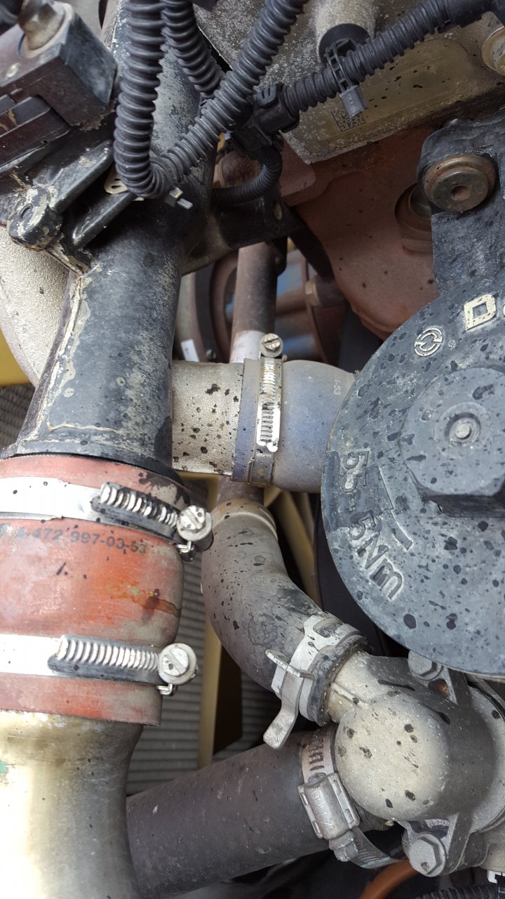

    20191212_120110.jpg Or just a loose clamp (and it was). But what worries me is amount soot. It connects EDR cooler to intake on DD15.

    The amount of soot really isnt a big deal but it looks like it was wet which might be a problem. Im not a DD guy but I would think that everything should be dry in the exh system. If its not using coolant then maybe its fuel or oil causing the wetness look to the soot marks and spots.

    Loosing Coolan? - Cracked EGR COOLER!
