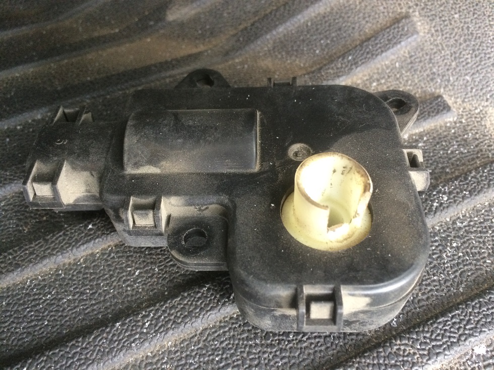

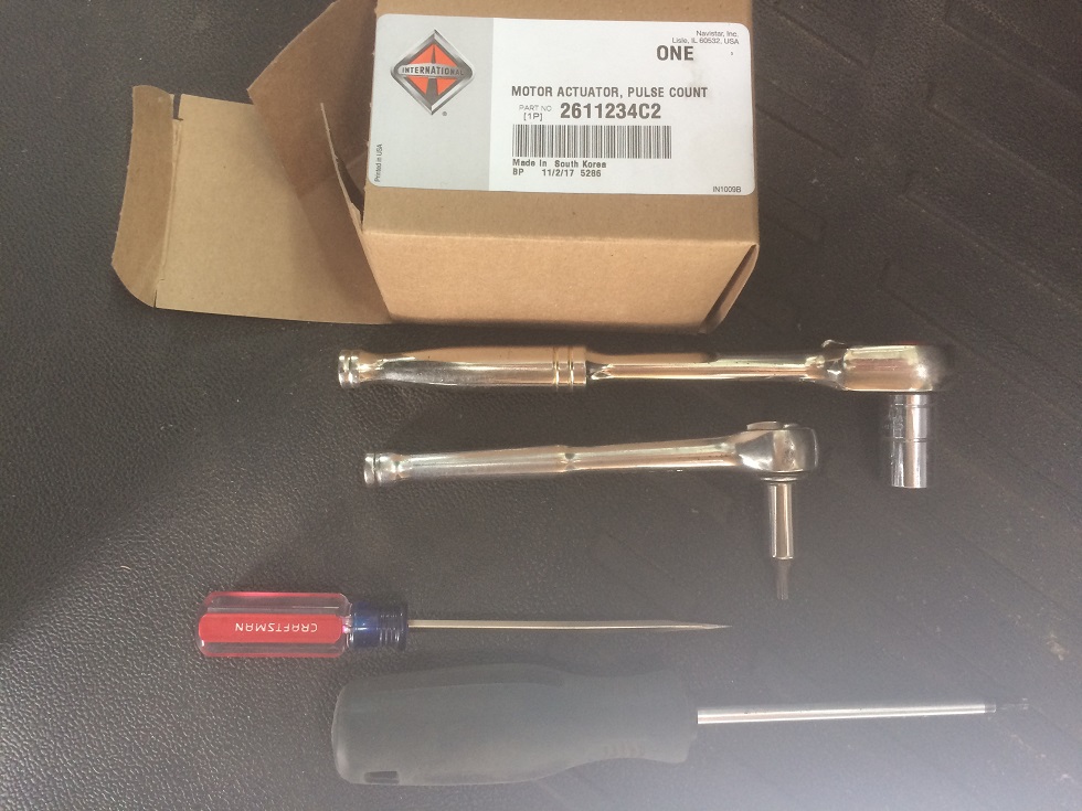

    Thanks Heavyd I was waiting for you to chime in. Even though I am new to join I have been reading troubleshooting posts for awhile. I will answer my own question and post some pictures on the solution. It was indeed the blend door actuator and the plastic had broken. So this had nothing to do with the repair shop, probably happened when they turned it full cold to test the new AC pump . This particular actuator isn't too bad to get at but the one further in that controls defrost or panel is a real bear. Here's the tools required. You will have to remove a few panels to get at it with a torx bit.
