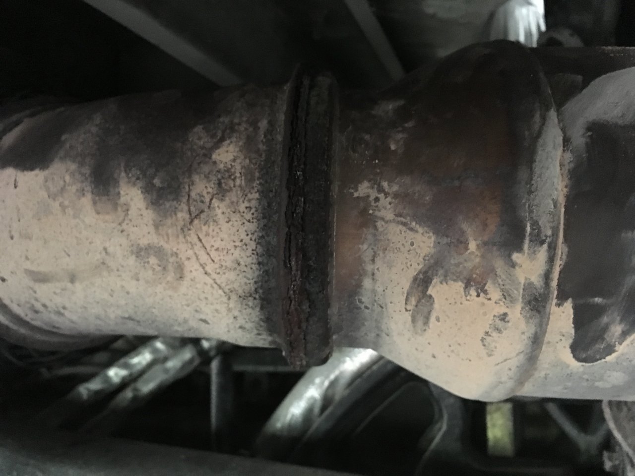

  6. colonel99
    colonel99 Bobtail Member
    4
    Jun 28, 2017
    IMG_4532.JPG I thought it was welded underneath the clamp, but it was just rust. Broke free fairly easily. Thanks again. Now to go get the new one.
