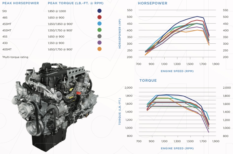

    The 485 spec doesn't look altogether that impressive on either chart, but it beats the crap out of the 405s I was driving as a company driver. There being 455MTs could explain why some of the 455s pulled away from the higher rated trucks.
    I asked about rerating the engine to 510 1850 and they said I'd need different turbo, injectors, etc. Does anybody know if that's true?
    I'm also kinda curious about the 455MT/1650/1850. It looks like that spec has higher horses and torque in most situations than the 485 1650 does. The 485 spec on my truck only has more power above 1450rpm to about 1850. The 510 is generally higher but the 455MT 16/1850 even has places where it beats the 510.

    It’s a medium bore engine at the end of the day. It won’t do what a 15+ liter Cummins or Caterpillar will. Compares well to a 12.7 Detroit. I think they topped out around 500/1650. Had to get the 14 liter to get 1850 and 525+

    The 510/1850 torque curve looks the best by far. I’m not sure about re-rating one. Haven’t had the chance to talk to anybody about that who would actually know. I have a 455/1650 with 2.79 rears and the older Fuller Advantage 10 speed which was superseded by the 12 speed, which probably has 2 or maybe even 3 overdrive ratios to choose from. I’ve never looked up the cog ratios in mine but pretty sure 9th is 1:1 and 10th is probably something like .76-.78. It’s about a 300 RPM split. Worse is the split between 8th and 9th which a more like 400-450 RPMs. Really have to wrap it up in 8th for it not to really bog down in 9th. So the whole truck is kind of a dog but I don’t haul anything that ever has me grossing more than 45,000. A modern 1-ton diesel pickup could easily haul the loads I do. Nothing I could do about it except put some shorter sidewall drive rubber on it and/or see if Kenworth could reflash the ECM to turn it up. Could also delete the inner 4 drive tires and steel wheels as I don’t need 8 of them back there. That would free up some horsepower not turning all that extra weight.
