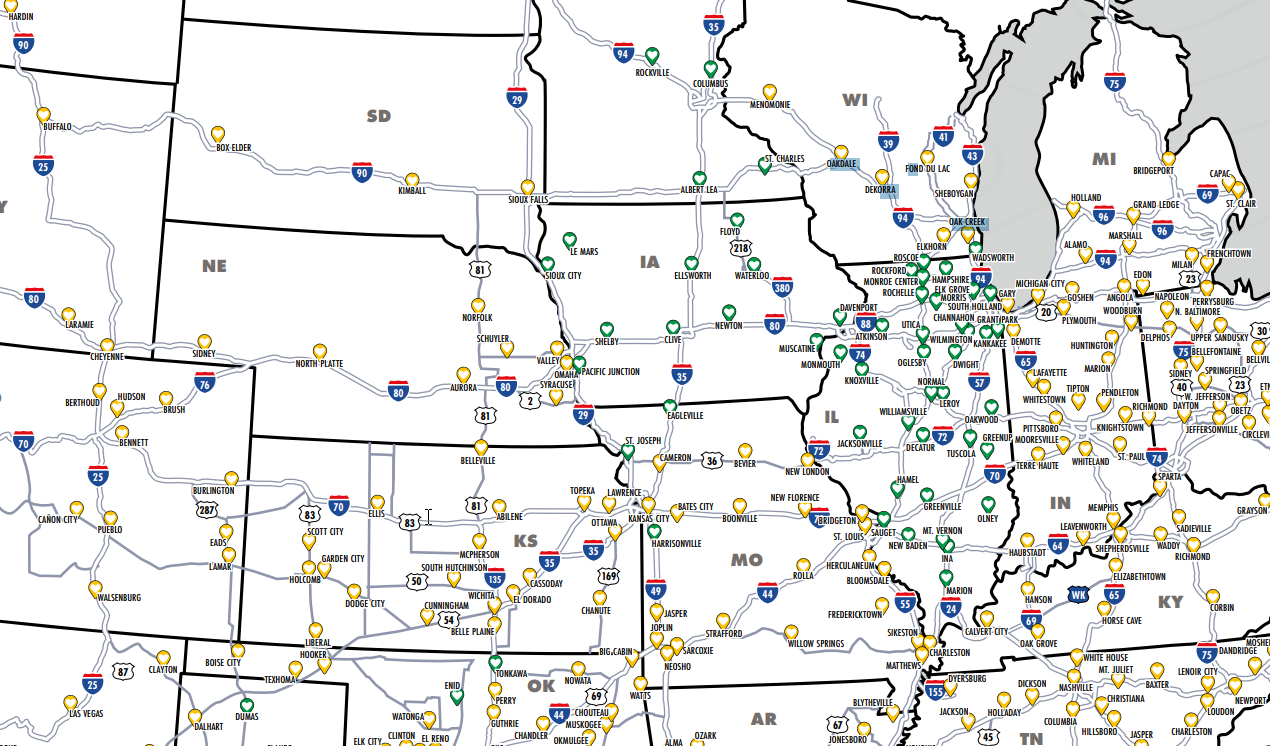

    So, this one is specific to Loves, but it's what I've got and my fuel card discount does ok at most Loves.
    Winter Fuel Program
    On this webpage, if you go down to
    "Q: Which stores are included in the CWP?
    Where it says "please click here to view a map", there's the map in PDF form. lovesexample.png
    It shows the winterized diesel (everywhere lol) and then the second page (which this is a screenshot of) shows Biodiesel vs Normal Diesel.
    Green is Bio, Yellow is Normal. I almost put Bio in in Tonkawa, Oklahoma till I found this map, at which point I fueled in Ottawa, KS instead.
    I find, for instance, Menomonie, Wisconsin to be valuable to fuel up before heading into Minnesota Bioland as well.
    As you can see, Iowa, Minnesota, Illinois, all green=bio. Random places in Texas, Missouri, and Oklahoma are bio too.
    But yeah, I've decided not to go to 24.5s. Jury is still out for me on super singles. I'm not quite sure. There are less drastic measures I could take for fuel economy, but then again, with what I'm already achieving plus the other measures I can take, the super singles could help boost it to real impressive levels.
    My truck doesn't even have aero side skirts! Aero skirts are expensive, however. I need to buy new drives relatively soon regardless, but I may just keep running duals for the first set of drives. Most likely I will, unless the super single rims+tires are together cheaper than just duals.
    If I do end up doing super singles, it'll need to be a variety that performs well on ice and snow. From time to time I will simply have to contend with it if I ever want to go home, living near Sioux Falls in the winter.
    Brandonpdx Thanks this.

    They sell Roadmaster XL premium diesel at the Cenex in Menonomie, but I don’t any discount there so it turns into an expensive tank of fuel. Most Kwik Trips in WI sell Bio free TundraMaxx premium blend and I actually do get a discount there. Petro in Portage has very good fuel and it’s always fresh because of how fast they turn it over.
    Loves I just don’t go anywhere near for several reasons, including the fuel. MN fuel hard pass also.

    Roadmaster XL from Cenex is good because it has additive injected in while loading.
    The other places will have the same fuel from the same rack. Just regular X grade diesel.
    I’m not sure about the Love’s map. We don’t haul for them so I’m not sure what their setup is in Pacific Junction and Shelby. Either they would have to get some bio first and blend in their trailer or they have an underground tank and blend at the pump. The TA in Council Bluffs has a bio tank and up until a couple weeks ago they hadn’t been blending because the tax credits went away.
    That’s the thing with bio and ethanol. If the government stopped subsidizing it then they’d go away because it’s not worth it. But we need to subsidizing the farmers so then we end up subsidizing the bio fuel and ethanol producers and give tax credits to those selling the product to the end user.
