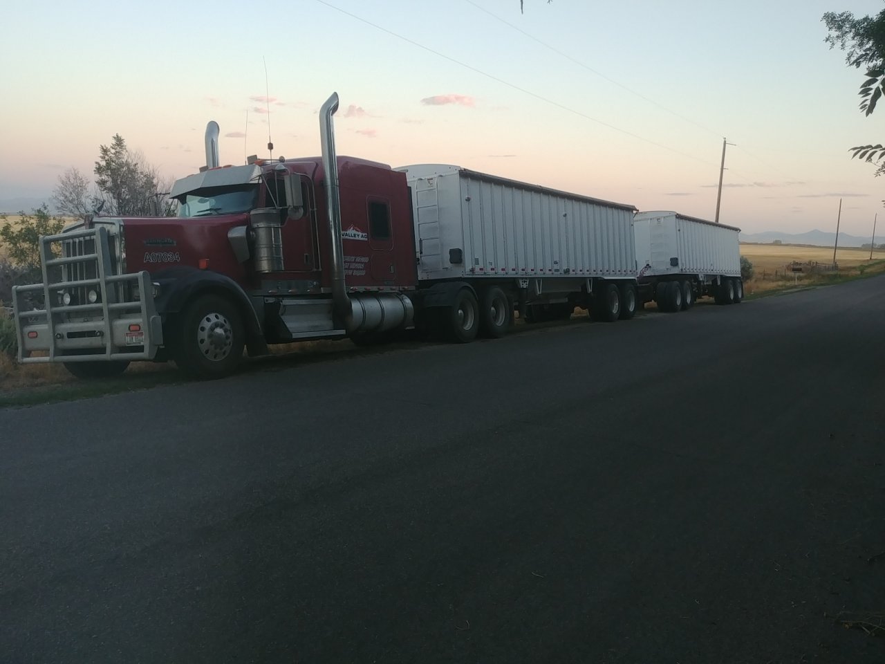

    Ive never pulled double 28s, but I would imagine they probably track just as good if not better than a single 53. I pull A-Train tankers and hoppers, doubles just require a little more finess and attention. With my hopper train I'm 110 feet bumper to bumper and I can get into some moderately tight places without much problem...

    Boy, that sure is a whole lot of truck. My hat's off to you for being able to pull that around. I can say, without reservation, that I wouldn't feel safe behind the wheel of that without a few weeks training by an old hand like you. Thanks for your post. I'm kinda looking forward to learning another part of trucking!

    I appreciate the compliment, but I wouldnt call my self an "old hand" by any stretch of the imagination.
    I'm pretty much a self taught driver, never have had any training perse... Just a handful of instructions from my Dad, lots of common sense, and time behind the wheel.
    Just take your time, keep your wits about you and you will do just fine.
