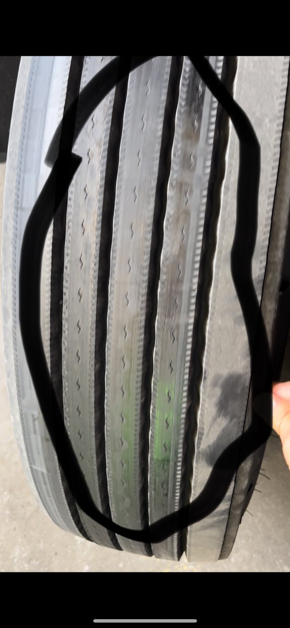

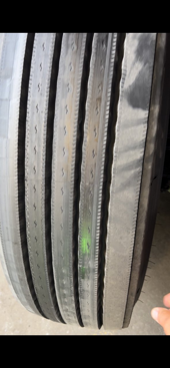

  7. Dok2304
    Dok2304 Light Load Member
    185
    49
    Sep 19, 2013
    I just installed them last week, did only 3k miles. I’ve replaced one tire first, because it had flat spots it was not legal. I had a loose ubolt on the rear that messed up my Aligment and everything, so I kinda blamed the ubolt on the rear axle passenger side for the flat spot on the driver steer tire.
    Anyway I started to have some vibration, so after I replaced the driver side, I was expecting to have a smooth ride, but that didn’t happened, so after I delivered and came back home, I decided to stop again and change the other. The vibration was still there, but I never suspected the tires, because they were new.

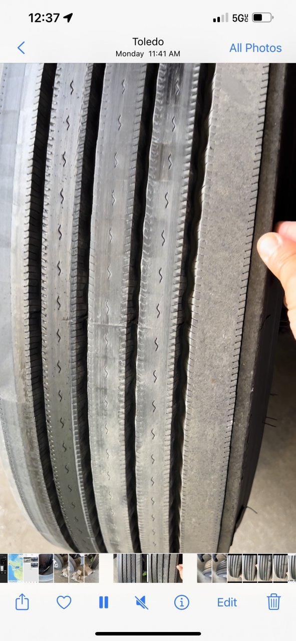

  8. Dok2304
    185
    49
    Sep 19, 2013
    This is the tire dirty area

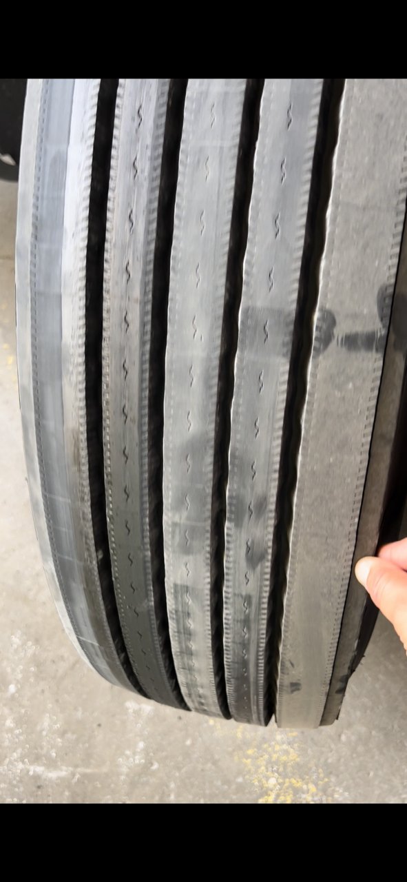

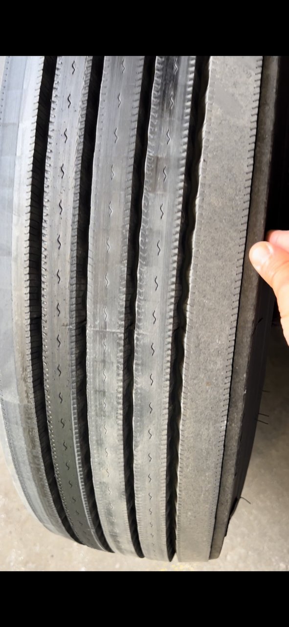

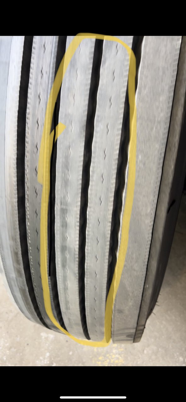

  9. Dok2304
    185
    49
    Sep 19, 2013
    This is the other area , you can see the difference

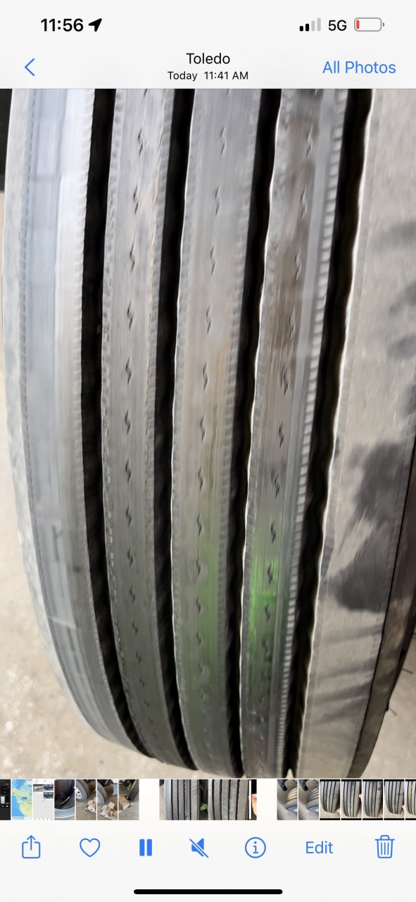

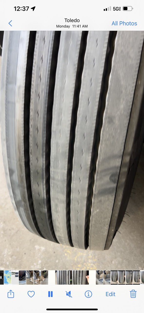

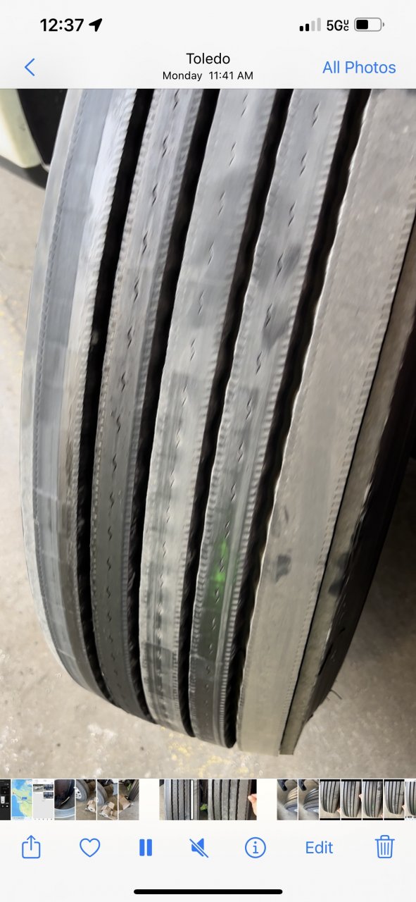

  10. Dok2304
    185
    49
    Sep 19, 2013
    Here are some more pictures, I had trouble converting them from png to jpeg, can’t upload as png
