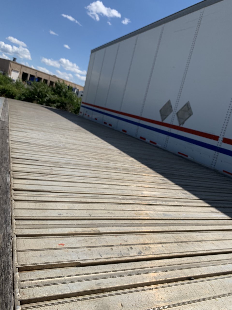

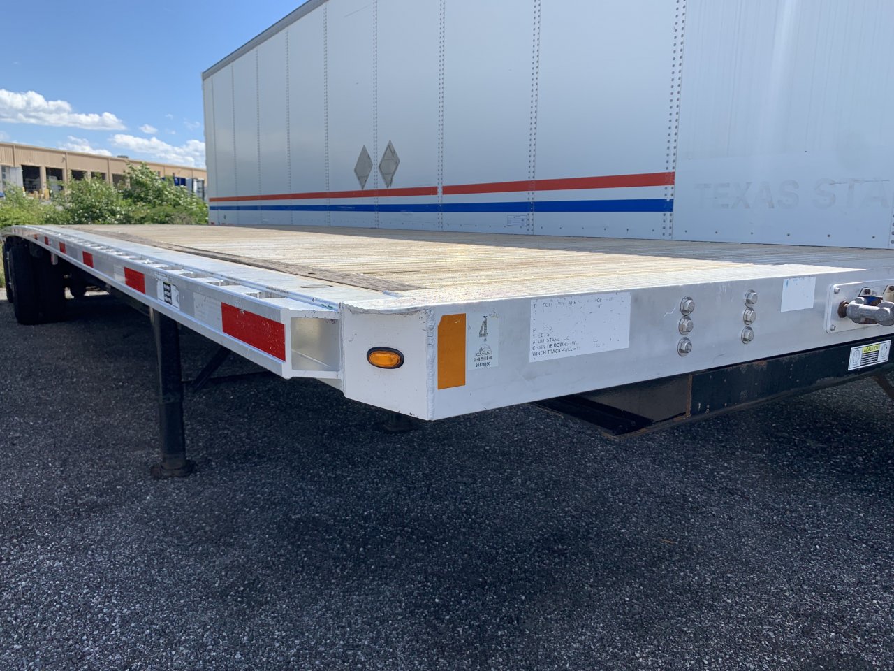

    So I found a 2014 Fontaine Revolution. Paid 21k. Now looking to purchase all needed equipment. Here is my list, no specific order. Please chime in, suggestions, preference, where to buy etc.. I have no specific load other then bagged municipal waste. Other then that is what ever I can pick up coming back to NYC From va,oh,nc,sc, md,pa, mi.
