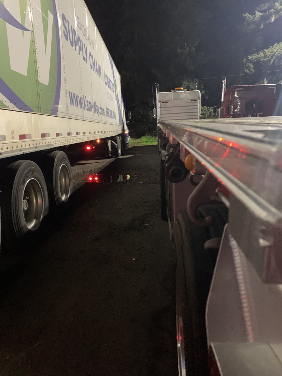

    Okay, kylefitzy, I see that I stand corrected about the rub rail verbiage removal. And you're right, there is some contradictory information from the FMCSA, about the reason for the removal being manfacturer lack of standardization in design being applicable to all flatbed type trailers (the one in your picture being an example); the lack of consistent enforcement and interpretation.
    The point you note about lack of rating of anchor points still has a weak argument point. In the section I cited:
    (c) Vehicle structures and anchor points. Vehicle structures, floors, walls, decks, tiedown anchor points, headerboards, bulkheads, stakes, posts, and associated mounting pockets used to contain or secure articles of cargo must be strong enough to meet the performance criteria of § 393.102, with no damaged or weakened components, such as, but not limited to, cracks or cuts that will adversely affect their performance for cargo securement purposes, including reducing the working load limit.
    The language quite clearly states that the anchor points must be strong enough to secure the load in accordance with § 393.102, so there is an implicit requirement for the tiedown points to be rated. I'm sure, even the trailer you show in the picture, considering the metal thickness, welding and tensile strength is the reason a manufacturer puts those D-rings and holes for anchor points there for you to secure to. I don't have your trailer documentation, but I'm pretty sure it would outline what they recommend or specifically don't recommend, what you can use as an anchor point.

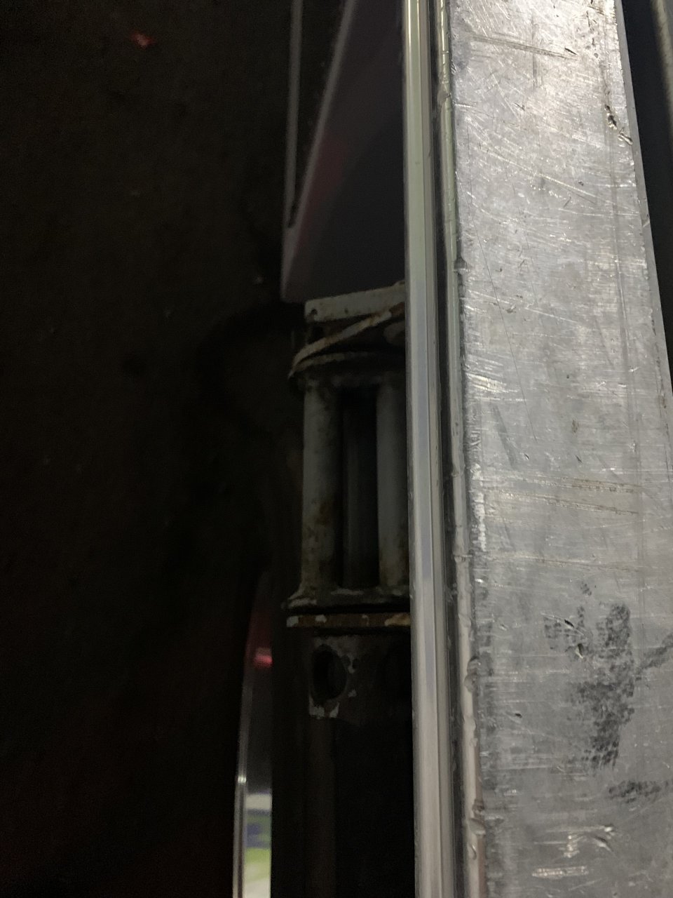

    While I agree that anchor points and similar items need to be strong enough to secure the cargo without deforming, that does not mean they need to be rated. Raiting Main’s there needs to be a publish number by the manufacturer, backed up by testing under control the circumstances. If something is not explicitly stated in the regulations, you can’t receive a citation for it.
    This trailer I’m pulling only has D rings in a few locations in a well, and none of them were in the right location for this load. Those are the only rated anchor points on this trailer. Everyone’s free to do as they see fit, but I have no problem using unrated anchor points as long as they are Structurally sound, including rubrails on aluminum trailers. I’ve never had an issue.

    Most of the flatbed trailers I have seen in the PNW have the non sliding winches on the outside of the trailer and they go over the rubrail with the straps.
