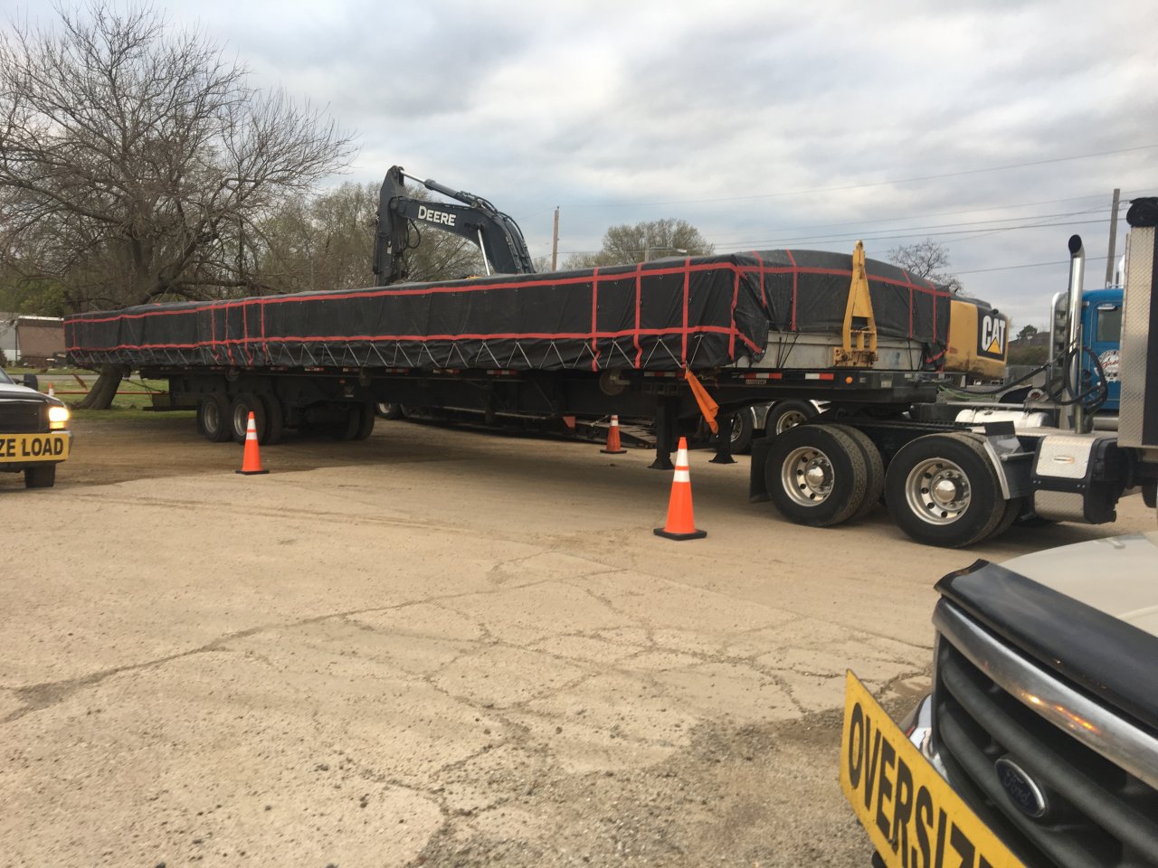

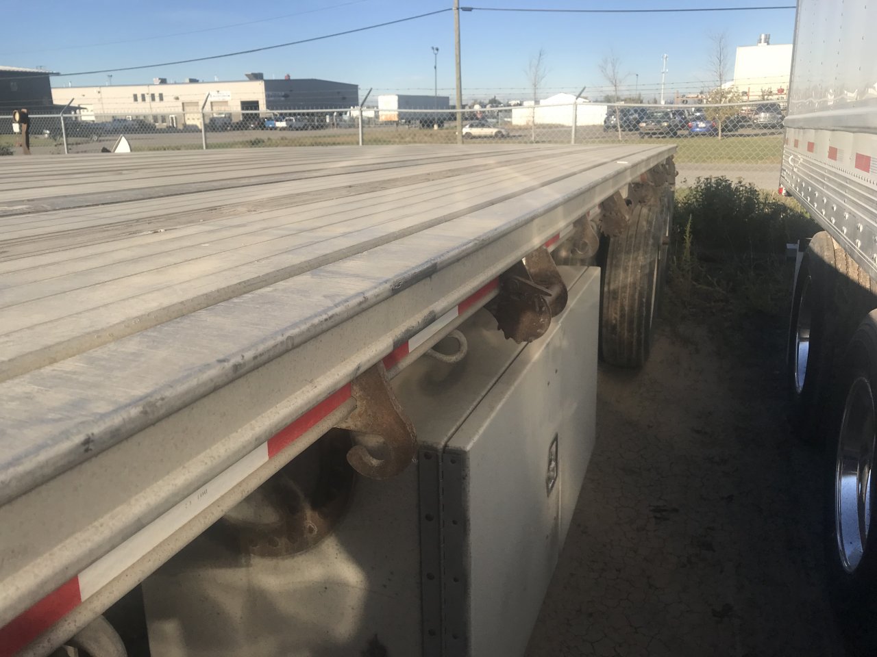

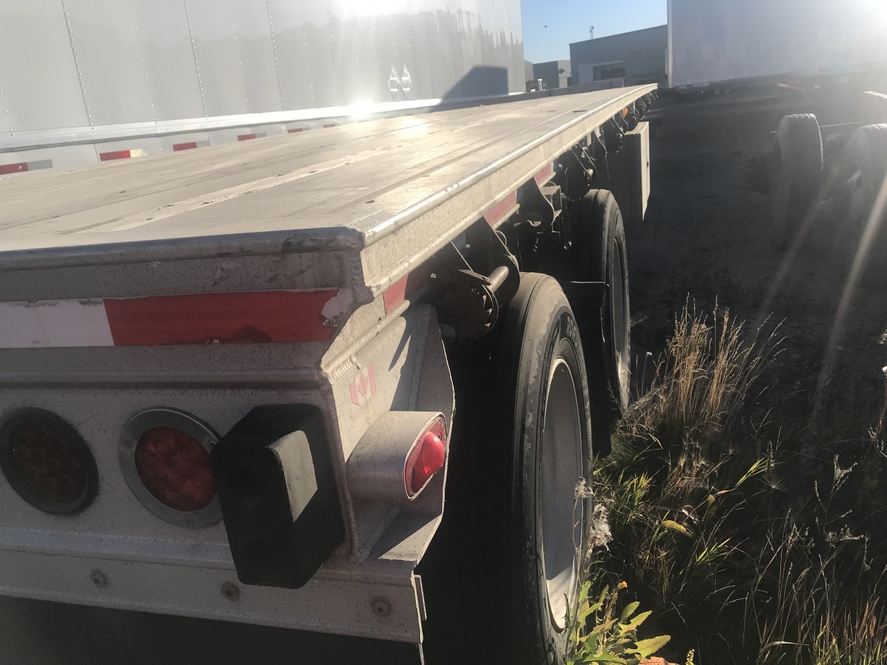

    Does anybody knows how to tarp this trailer?No Rubber rail
  9. kylefitzy
    kylefitzy Road Train Member
    4,651
    19,258
    Aug 12, 2007
    Kansas city,Mo
    With bungee rope, the way all trailers should be setup.
    Dadetrucking305 and beastr123 Thank this.
  10. REO6205
    REO6205 Road Train Member
    13,172
    60,500
    Feb 15, 2014
    California.
    Do you like the hollow core or the solid rubber rope?
    Dadetrucking305 Thanks this.
  11. kylefitzy
    4,651
    19,258
    Aug 12, 2007
    Kansas city,Mo
    I use 3/8” shock cord or bungee rope. I e tried the regular rubber rope before and didn’t like it. It was way to “grippy” and wanted to grab the d rings as it was pulled tight. It starts out white. D28A86D3-9ABA-4D33-8433-212E943E6EE3.jpeg
