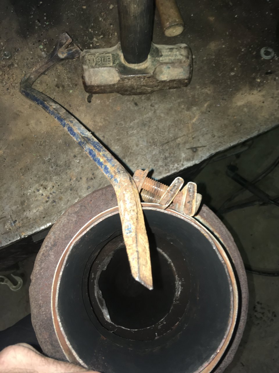

    Back in the day we would hack saw the ends off a car drive shaft , grease it up and drive it down through the muffler.

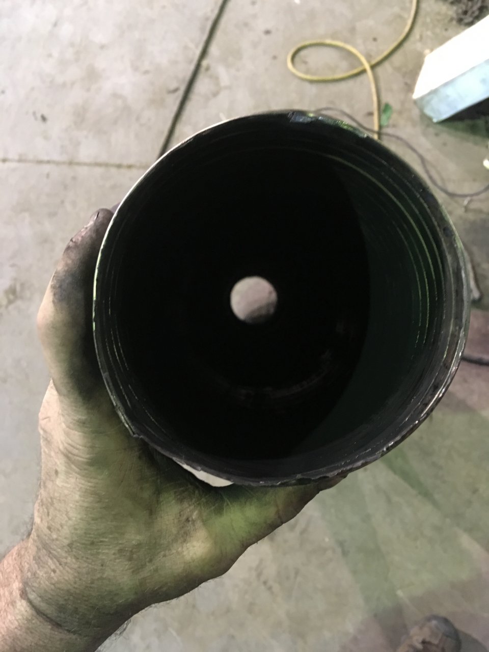

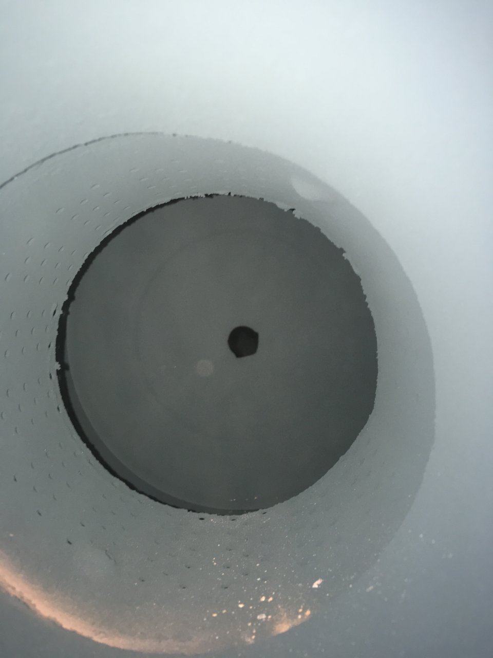

  3. rank
    rank Road Train Member
    9,918
    113,504
    Feb 11, 2010
    Before
    After
    4BE0675D-8E79-4F97-B56A-E07D8A36A318.jpeg A4242AF5-53E4-424F-A7C1-659BF247F954.jpeg

    There isn't a diesel engine out there that runs better with a restricted exhaust flow. What usually happens is guys just bust the baffles out and put the mufflers back on. When it opens up from 5" to 10" then goes back down, it create turbulence which creates even more back pressure than if it was just the baffles in there. It's one of the worse things you can do to a muffler. Slide a piece of 5" pipe into the muffler and you're good to go.
