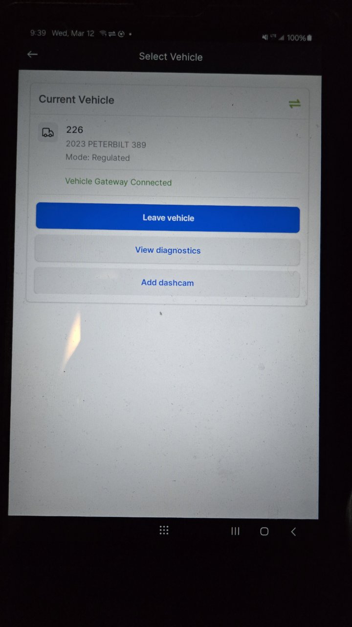

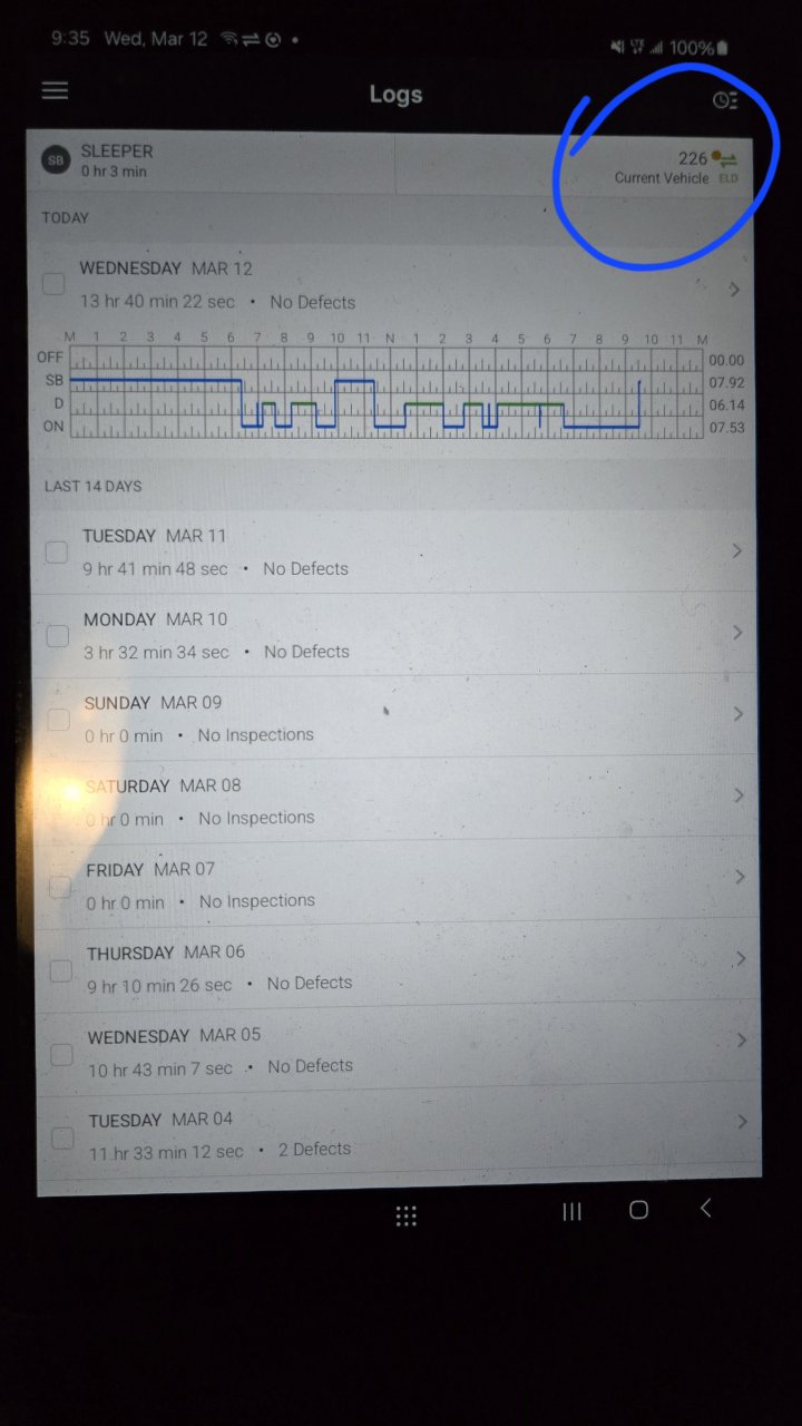

  4. sirjeff
    sirjeff Medium Load Member
    If you click that button, it brings up a menu with "leave truck" as an option.... does that work? I've never tried it

  5. BlackjackCo
    BlackjackCo Light Load Member
    159
    665
    Mar 29, 2024
    Just leave original truck and connect to new. I've done it multiple times. Only real challenge is that when someone else drives one of the trucks you have left and doesn't "connect" I've had motive try to "edit" or ask about "unidentified trips" that the other driver did in a truck I was previously in. So you'll have to do a lot of rejections. Other than that it's smooth

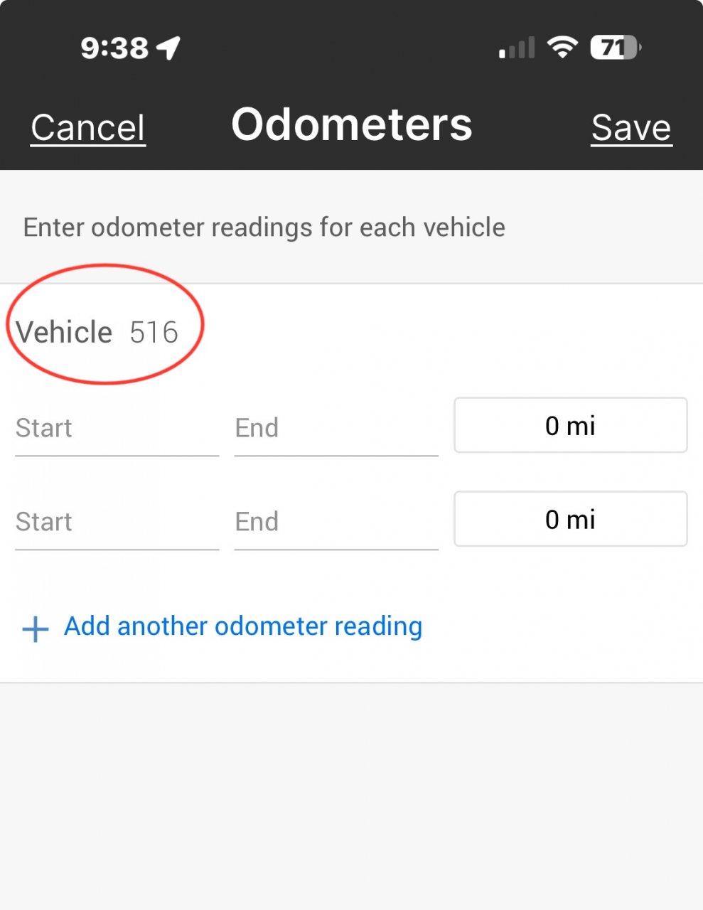

  7. 25(2)+2
    25(2)+2 Trucker Forum STAFF Staff Member
    18,776
    46,378
    Sep 18, 2006
    the road less travelled
    The local guys with an assigned truck do not have ELDs installed, if I get one of them, I use the app, just have to mark the drive portions manually and remember to stop them.] That includes yard move and personal use. I have to mark an odometer starting point to start this with a different truck. And all odometer entries are also manually input.
  8. corneileous
    corneileous Road Train Member
    1,366
    335
    Nov 19, 2009
    Podunk, OK
    Yeah see all I did was just noted in my graph remarks my pre and post trips for both trucks and even though it showed a truck number where it’s circled in the screen shot, I just wrote the beginning and ending odometers of both trucks down below that with the first truck I drove first on top in the first entry and the second truck I drove below that.
