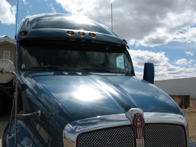

    It's not bad enough to repaint. I bought a clay bar kit and also a variable speed buffer with some goodies today. I'm sure it'll come out fine with the new power tool. New tools always make things OK. :biggrin_25525:
    Currently here's how it looks. That's after the rubbing compound and no wax. The hood isn't peeling, that's the sky reflection. I'm sure the clay bar kit will kick butt on it though. If not, high speed buffer will let me get it just right, then burn a big streak in the center of the hood, ruining the job.:biggrin_25523:
