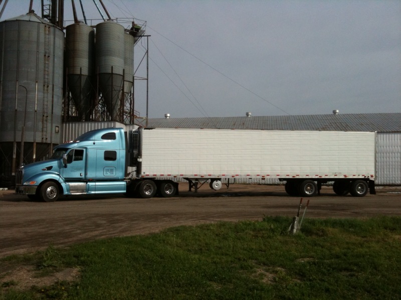

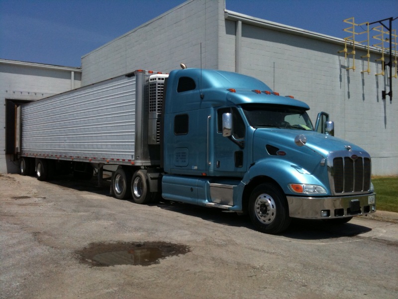

    Spreads are the bomb!
    BigJohn54, Everett and Jfaulk99 Thank this.
