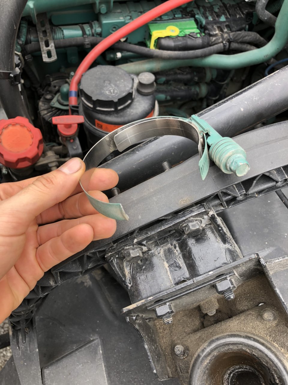

    Hi Guys
    Quick question - I get a gushing AIR burst in the cab when I accelerate the fuel ??
    so its like a strong sound of air gushing when accelerating - even when in cruse control - air sound coming from windshield area ? I cant put my finger on this noise.
    I'm thinking Turbo??
    * 2012 - Engine Volvo D13
    Thank You in Advance!

    no turbo boost leak, my bet its from the egr crossover where the egr temp sensor mounts on passager side, check it out probably have excessive power loss with it to.

  7. JerryD13
    JerryD13 Light Load Member
    169
    126
    Oct 17, 2016
    BINGO -- Thanks Again NazRiza !

    So what was it??

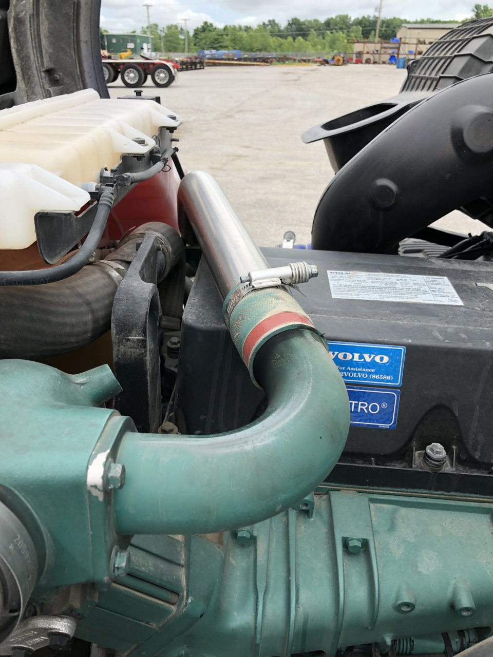

  10. Volvod13vnl
    Volvod13vnl Bobtail Member
    19
    4
    Mar 4, 2019
    Need advise.i tested for boost leak with air pressure . The guage on the air pressure tester drops but no leaks on clams towards the air charger cooler ,or towards intake manifold, or egr cross over pipe from egr cooller to the mixing pipe.Can the presure leak be bc the egr valve is open when tested coasing the air to escape ?
