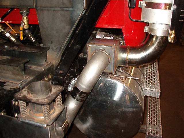

    @ Cat sdp - thanks for the picture. Do you recall the cost for this and where you purchased it? The heat get pushed along the underside of the bed in the channels or something different needed?

    I’m a trailer driver... not sure on the specifics on the heat set up....,.
