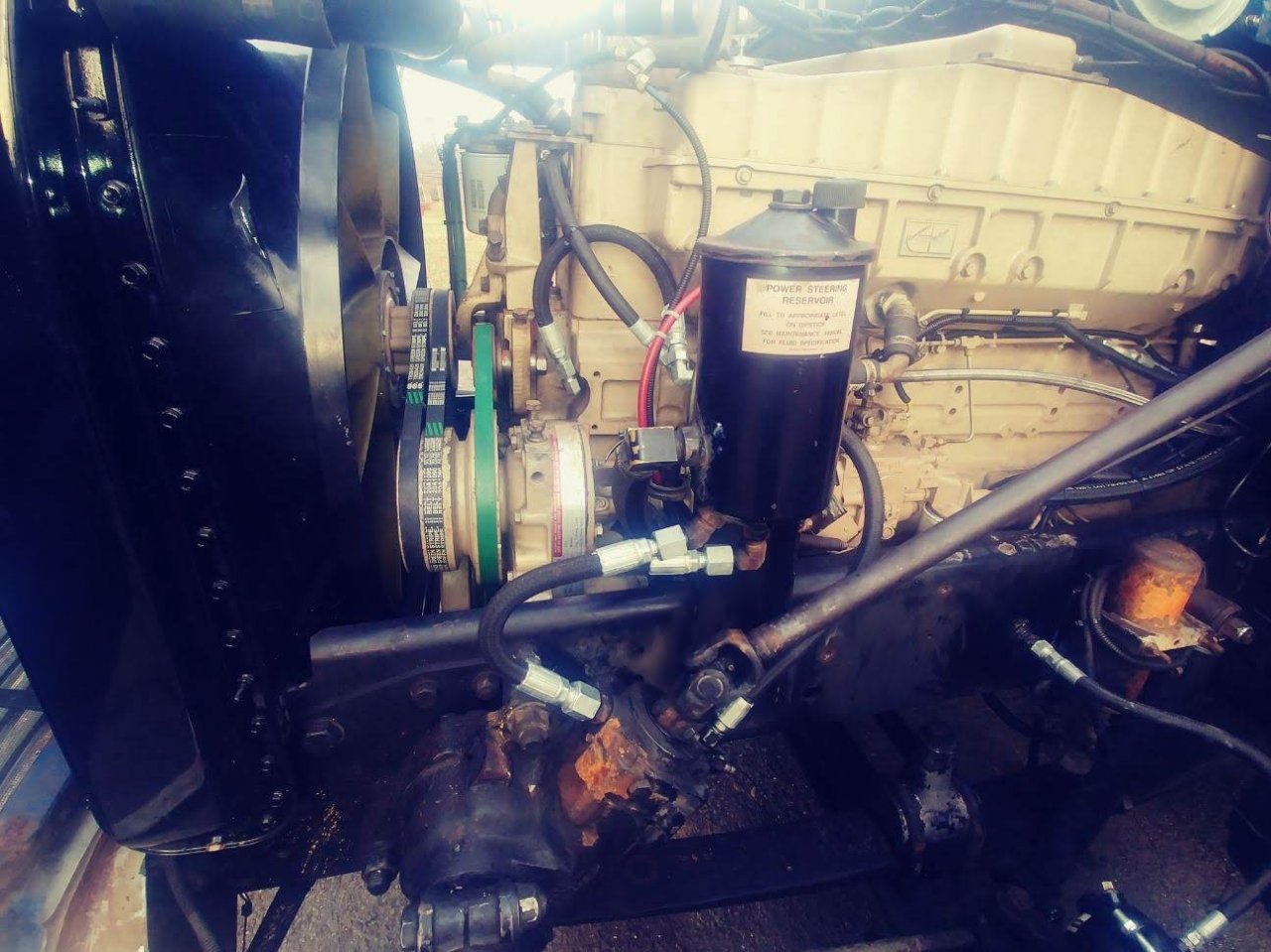

    Ah, my friend, the Cummins big cam is indeed very special.
    The first big cam Cummins came out in 1976. That design was so spectacular, it continued right into the early 1990s.
    And from there it was so spectacular that Cummins used the exact same block and made the n14 engine, the electronic version of the mechanical big cam until the year 2000.
    The n14 is still highly regarded as one of the best electronic engines ever made.
    However, with the big cam you have no electronics to cause you problems. I just read a post the other day where a guy had an electronic problem and spent $10,000 trying to fix it. This is very common that this happens. If you have an electronic problem, dig deep in your pocket because you're going to write a check for at least $5,000 to $10,000. And if you get into emission problems you might as well remortgage your house.
    But that can never happen with the famous Cummins big cam! You could take the batteries out and Coast down a hill or have somebody pull you and that thing will start right up and run as long as it has fuel in it- even for weeks or months.
    Electronic injectors are about $400. Injectors for the mighty big cam are $65. Multiply $400 x 6 and then pay someone to do the overhead and you could have rebuilt the big cam at least twice. They are very inexpensive and simple to work on.
    Now the engine that you have is 300 horsepower. That engine has the identical same block heads and pump as a 400 or more horsepower big cam. So the point is that same engine can be rebuilt to 400 450 500 even 600 plus horsepower. You just need to know what parts to use and how to set it up. But it's the same engine.
    I read a post on here that a guy said he spent $40,000 on a new engine. Think about that for a minute. $40,000! In some parts of the country you can probably buy a house for a little more than that.
    Yet if you find that place in North Carolina, you can buy a brand new big cam engine for $11,000. Or you can buy the rebuild kit for somewhere between $1,000 and $1,200. Would you rather spend the $11,00 or would you prefer to spend the $40,000? And that guy might start that truck up and drive around the block and have to spend another $10,000 on electronic problems. Makes no sense to me, but I digress...
    The big cam will do anything any other engine anywhere will do, except it will do it more reliably with less expense and all you need to fix it are some wrenches and screwdrivers. I have no desire to get a master's degree in electrical engineering to work on my truck.
    Electronic engines are mechanical engines that have all kind of electronic junk put on top of them that only increase problems and expense and headaches. It's just more expense and more to break and more to fix.
    The mighty big cam only needs fuel, air, and compression!
    I get it. Not everyone can take an old truck and work it over, or transplant a big cam engine in place of the electronic one like I did.
    But if you have the grit to make it into something good, when you are done you will have something that is absolutely spectacular.
    So yes, the mighty big cam is very special indeed my friend.
    Very special indeed!

    I realize there were changes as they went through the different series of big cams and n14s. I'm saying it's all built on that same 855 block. Those were variations on the original design.
    So I have a big cam 3 and a big cam one. The blocks are the same as far as the Pistons and crankshaft and camshaft fitting, Etc. Now the big cam 3 has a different type of a mount for the fan that's pre-drilled. The big cam one fan mounts onto the water pump itself. I was actually able to use a fan mount and Fan from an n14 on the big cam 3. The oil cooler situation on the bc3 is a little bit different and the block is set up a little bit differently for that from the bc1. If you visually look at the two side-by-side the water jacket covers on the big cam 3 are in a little bit of a different position. From what I understand the big cam 4 is set up a little differently with the water manifold or something on that part of it is made just a little bit differently. But those are all small variations on the same block is the point I'm trying to make.
    The same with an n14. If you set the blocks side-by-side there may be some small differences kind of like between my big cam 1 and big cam 3, and I think the crankshaft journals may be larger on the n14 and there may be some other small differences, but they're still built on that same design of that 855 big cam block. Same displacement, too. If you pulled out an n14 and put in a big cam it goes exactly in the same place because it's virtually the same block and engine- with changes occurring through the series models, from the very beginning to the end of the last electronic series.
    You are right though. I hadn't thought about the small cam also being an 855 and it's also similar in design.
    So the 855 does go back many more years than what I had said.
    D.Tibbitt, BoxCarKidd and 650cat425 Thank this.

    Nice engine picture, Dino!
    Now that's a project.
