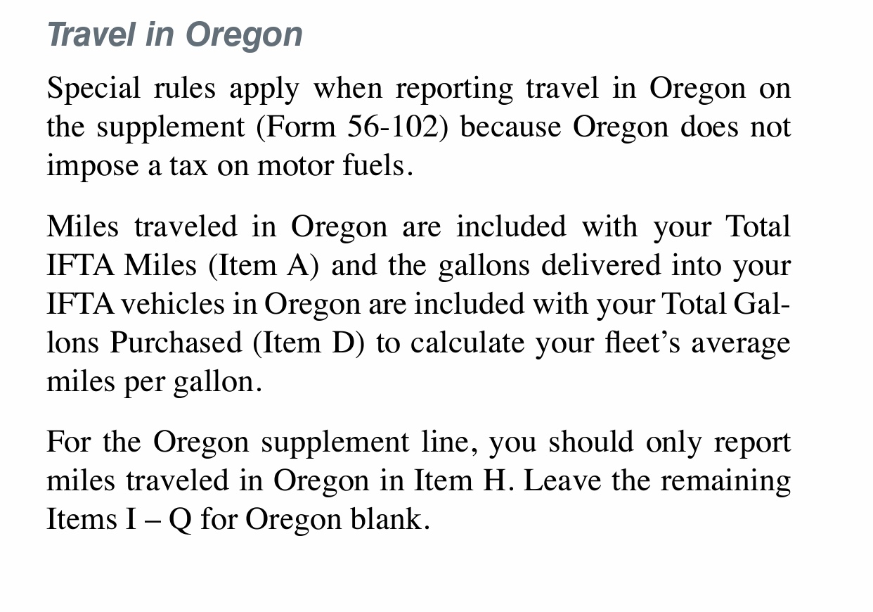

    I have a feeling that the OR tax is both a weight-distance and a fuel tax unlike NM, KY, and NY. Maybe I’m wrong. I’ve been trying to get that confirmed but keep getting different answers. The OR tax is very high compared to the others, but it may just be because there are more miles to travel in OR.

    I think I found the answer from the IFTA manual. In short, it’s not a fuel tax.
    Long FLD Thanks this.
