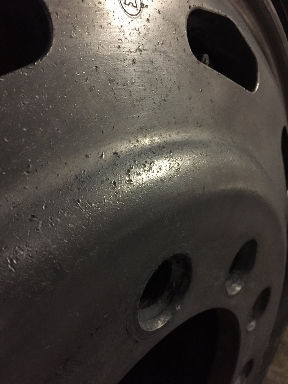

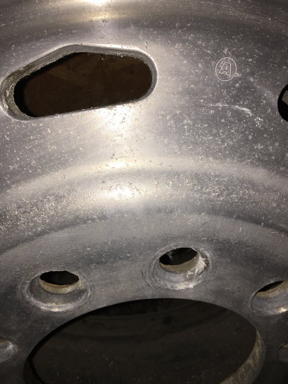

    I’d like to polish up my wheels this summer but had some questions. If you can see in the picture, I have some pretty deep rock chips. Can these be sanded out? If so what should I start with? Would starting with a scotch pad be best?

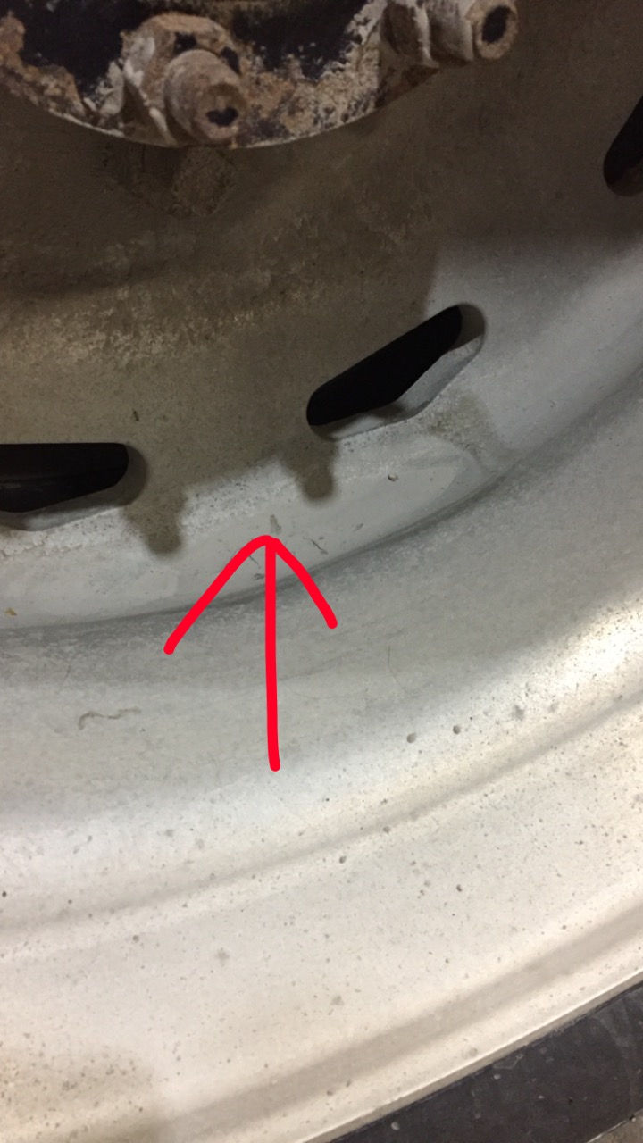

    Also what is the best thing to use sanding the inside of rims with a dish like this? The videos I’ve seen show guys just using an orbital sander, but I don’t see how you could get to the part the arrow is pointing to.

    I use a flap wheel to get into tough areas, orbital sander on everything else. You would be surprised how well an orbital gets into some spots.
    If there’s a lot of chips and oxidation, start with 80-100 grit, then work your way up.
    Think I used 100 then 180, 320, 600 and 800 when I did mine last.
    Then polish with rouge on a cutting or buffing wheel.
    It sounds great to DIY, but it’s time consuming.
