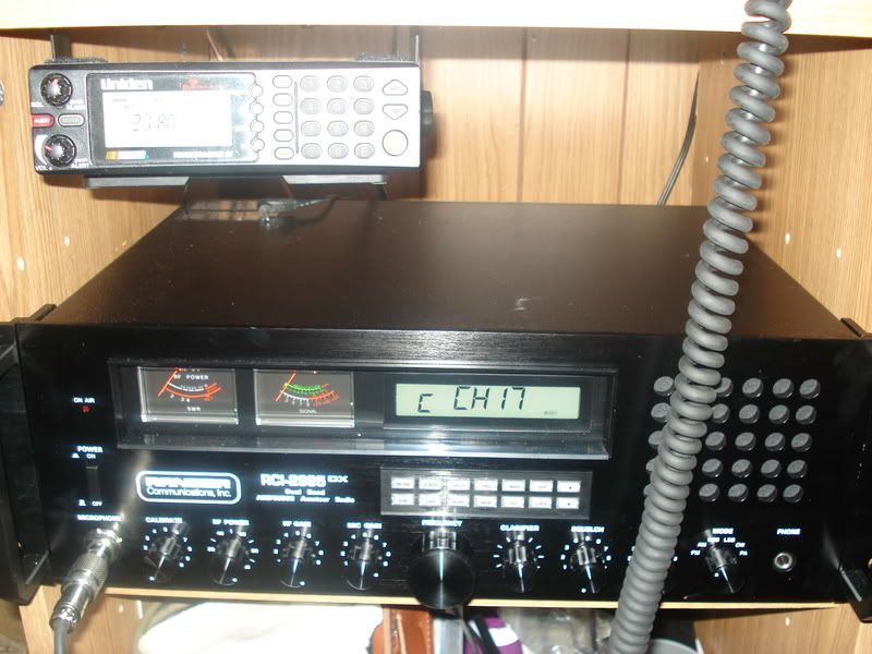

    I will just throw this in as well. If you want a very good base radio then go with a RCI 2995. They do over 200 watts have every channel you could ever want and or the closest to a full blown ham radio that you can buy for the money. This way for around $550.00 for the radio.. $250.00 for the antenna, coax and a few poles to mount the antenna on you will about talk alot of people with way more money invested.
    By the way, this is a RCI 2995.
