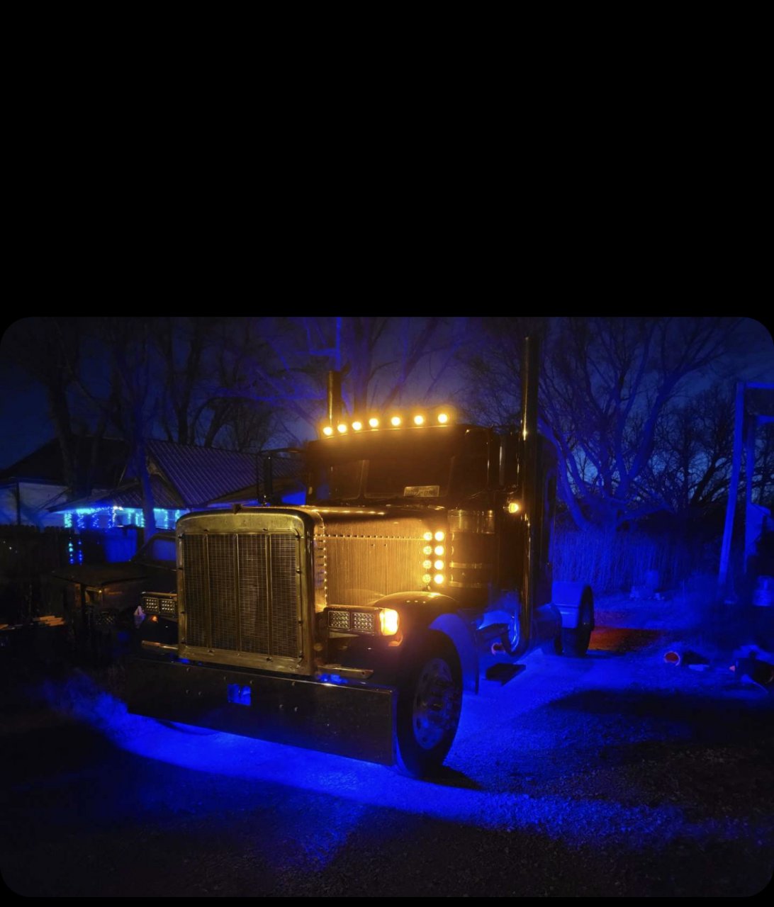

    Friend of mine has this truck for sale in Oklahoma

    Undoubtedly an old Shaker with a Series 60 and a 10 speed Fuller is a better value but these can be hard to find in worthwhile shape and especially if you want a 2-axle with a sleeper you're looking for a rare truck. Guys probably figure well, I can buy this thing (a Ford or Ram little truck) off the lot right here in town and make it work for now.

    Looks like it was spec'ed to haul hay in CA. That seems to be where most of them fancy 2-axle sleeper Petes originally came from. That's kind of a dream rig you need some cash for.
