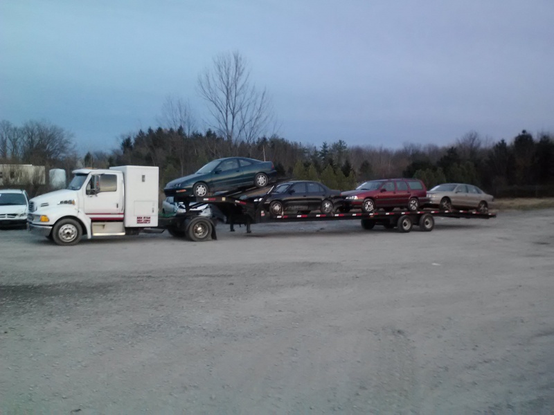

    Electric brakes on the infinity run about $200 per axle, but if your doing them once per year then you might as well do the seals and bearings well your in there.
    This was one of my set ups.

    Buying the wrong semi is just as bad as buying an f350 lol. Find yourself a pre emissions truck either N14 or series 60.
    Yes you're looking at around 1500 just in parts to do the brakes and bearings which you'll be doing once a year. More expensive than an air brake trailer!
