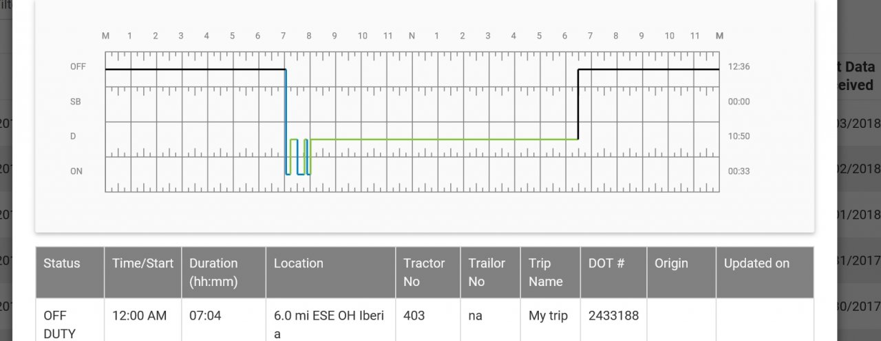

    The interesting part is; the graph rewrote itself overnight, while the “Eld Events” recorded the day’s events as they actually occurred. So, just looking at the graph would include several violations (since the graph continued on “Drive time”) after the driver had parked the truck. While the “ELD Events” shows compliance.
    I was able to edit the log into “Off-Duty” for the time after the driver logged out. However, I couldn’t go back and add the 30-minute break even though its logged in the “ELD Events”.

    Yea you can’t change drive time you can fix break or on duty but nothing when it comes to driving
