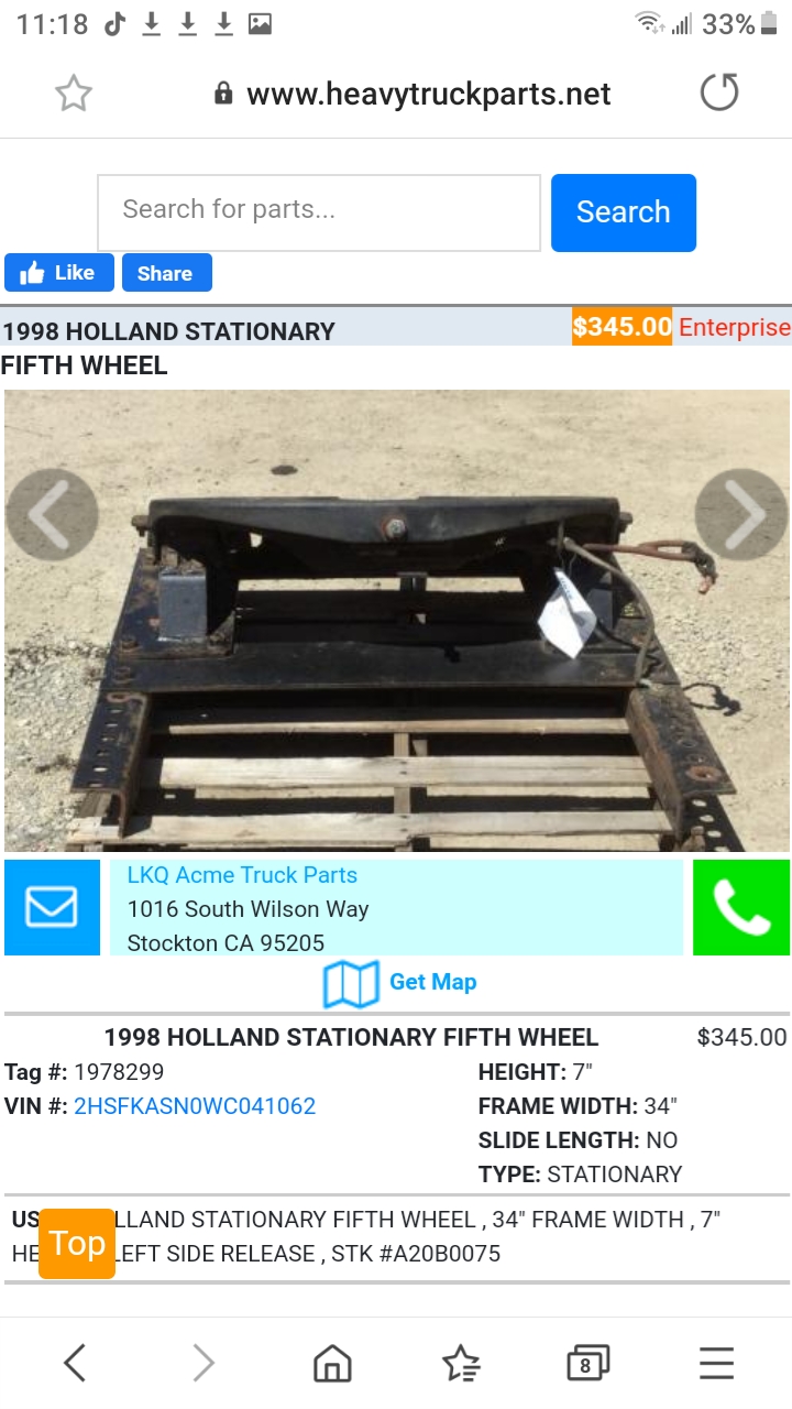

    So I forgot you keep mentioning a bolt on gooseneck ball too. Do you mean something like this.?
    So those mounting holes will line up with a Hitchcrafters mounting plate for the Binkley/Holland 32k, or maybe the new 34k head they they are offering..
    So an idea that you may like better.. Get that ball mount for $165, & maybe copy cat the way this dude made his mounting plate. Homemade, yet looks quite professional too me. Very similar in design to the Holland stationary semi truck mount I posted earlier..
    He gives a pretty good idea how to do it. Adapt this design slightly for your Ford. Then just 4 bolts, you can switch back & forth between a goose ball, & 5th wheel as needed..

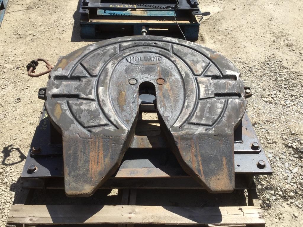

    That's a nice FW35 top plate but I still don't see how that mounting bracket works. Looks like the angled part that bolts to the side of frame is facing the wrong way (towards the inside of a C channel frame when it should be on the outside edge.)

    If it's going to be a dedicated 5th wheel trailer puller it's not a bad idea. Those full size 5th wheels wont ever wear out on a little truck.

    Seems pretty reasonable actually. The parts and hardware alone were probably half of that easily.

    Mines a 24" slider, but should bolt up like this. Outside of the rails..
    Never drill holes, or weld to the flange. Only make holes through the web..

    Yeah, I don't know if you noticed, but that says it's a 1998!! Dang 5th top plate must have seen very little use in those 22 years. LoL Thing looks almost new to my eyes..

    Okay I see. I was just picturing it wrong. What's the web and the flange? I know you are not supposed to drill holes on the top or bottom horizontal sections of a C channel frame. I that what you mean?
    singlescrewshaker Thanks this.
  11. singlescrewshaker
    4,691
    40,517
    Dec 31, 2017
    Little Havana, FL
    Yep, you got it right.
