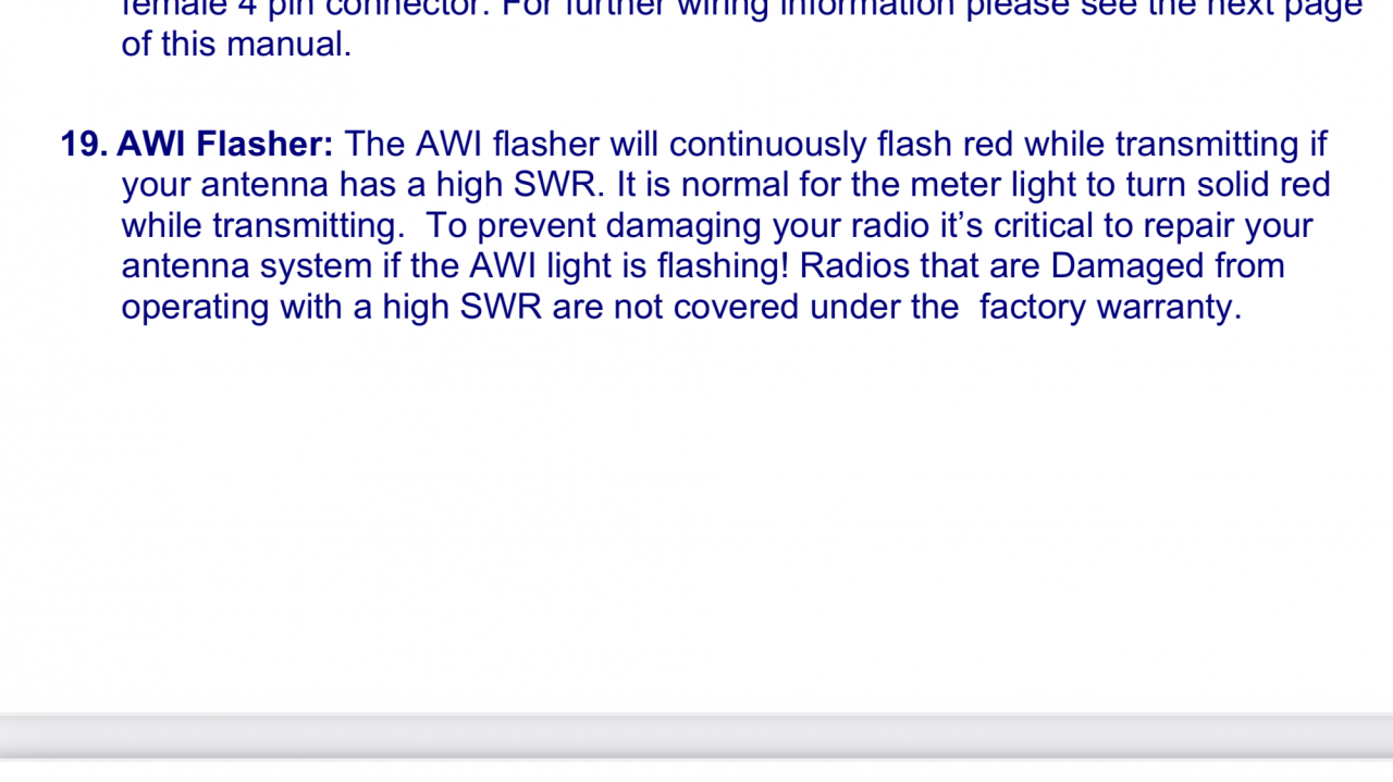

  8. Hulld
    Hulld Road Train Member
    2,882
    6,565
    Oct 19, 2015
    Upstate NY
    Just going by my radio manufacturers radio instructions?
    But what do they know they just make the radio.
    I’m sure they never actually used a radio before so that’s probably why they made the mistake in the instructions.

  13. Hulld
    2,882
    6,565
    Oct 19, 2015
    Upstate NY
    My light as per the instruction manual lights up red when transmitting and flashes only when there is an SWR issue?
