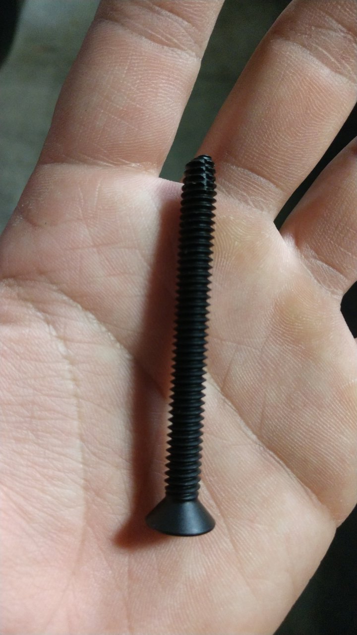

    We've always used these to redeck trailers. Drill a 3/16 hole first and they have a built in thread cutter on the tapered tip. T30 drive makes them near impossible to strip out. A 1/4" impact driver is the correct tool for putting them in.
  8. FLHT

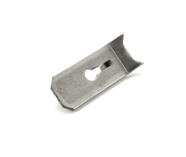

    We used these last time, the pointy ends dig into the wood and the other end grabs the cross member flange.
    6wheeler and 1951 ford Thank this.

    What are these called?
    6wheeler and johndeere4020 Thank this.
