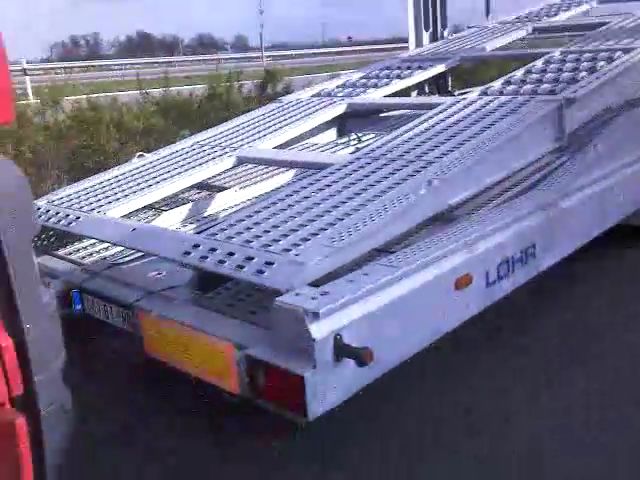

    i would not agree with this,italian products are made without much sense , in my opinion only good thing on rolfo is they can attach normal semitrailers while other have 5th wheel on back of chassis , here largest company use this feature very often they use same tractors to pull cars with euroformula bodywork and trailer and also they use semitrailers for truck/tractor transport and sometimes even normal curtainsiders
    interesting , thanks for explaining
    here in europe we have 2setups for hauling cars
    traditional is 2axle rigid truck pulling 2axle centralaxle trailer , truck have long wheelbase about 220-225inchs ,capacity up to 10cars( truck fit 5cars(3above 2down) and trailer fit 5cars (2above 3down))
    new combination is 2axle tractor with lower chassis and low cab and bit longer wheelbase(153inch) with removable body capacity 3-4cars , trailer have capacity of 7-8cars this give space advantage since trailer is much lower than truck compared to first setup , but problems with overloading axles, in recent years weight of cars is increased so many trucks have small pusher axle to avoid overloading drive axle
    trucks usually have 315/60r22.5 tires trailer 245/70r17.5 double or 275/70r22.5 single when car can fit in between tires , most usually when single tires are fitted than trailer is 3axle
    trucks have little bit lower(on suspension) chassis than normal (60mm) but this is not lowest chassis available total with lower tires 80mm , but it is still 100mm higher than lowest chassis
    trucks have full air suspension, drop front axle is normal on all on road trucks in europe , suspension can raise some 170-190mm depending on manufacture and lower by some 60mm
    cab is generally 2.7m from ground level some trucks have high cab but this make problem with those who order transport

    semitrailers by lohr and kassbohrer for russian market are build in serbia , i know some of guys who drive them to russia , some bodyworks for rolfo are build in croatia
    in europe we dont use semitrailers for car transport , because length is 16.5m and for car carriers is 21m and 4.3m height here

    yep, on our market 20 m from bumper to bumper limit, so we can use longer trailers.
    US car hauler trailers are like we use here
