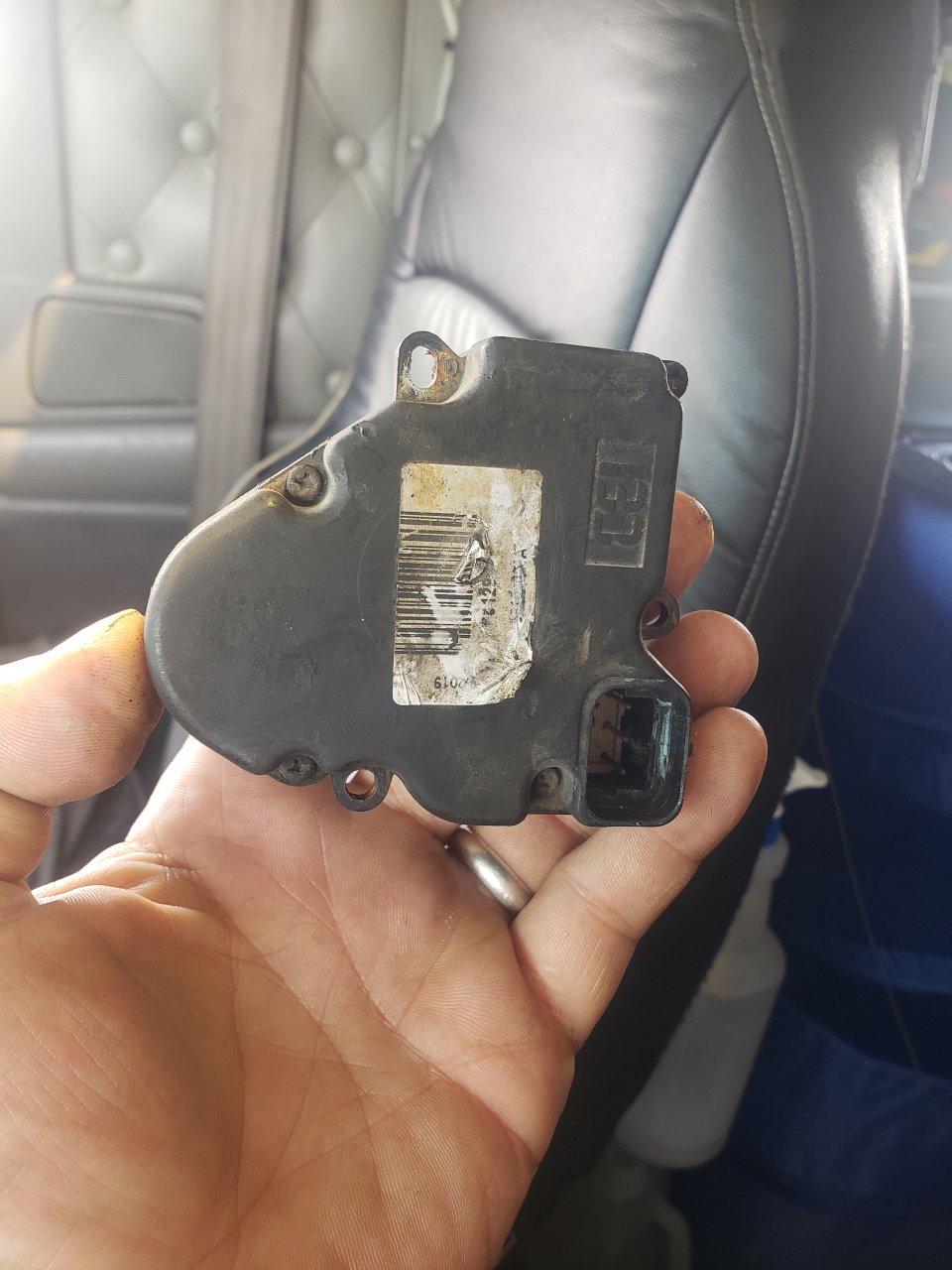

  10. HoneyBadger67
    HoneyBadger67 Road Train Member
    2,056
    4,512
    Dec 15, 2018
    Savannah, TN
    The water valve is not easy to find if you're not familiar with where it is. I'll try to remember to take a picture of where mine is hidden in the morning.
    mike216 Thanks this.
  11. HoneyBadger67
    2,056
    4,512
    Dec 15, 2018
    Savannah, TN
    Where I'm pointing is where the control module goes. It's just a naked valve right now.
    spsauerland Thanks this.
