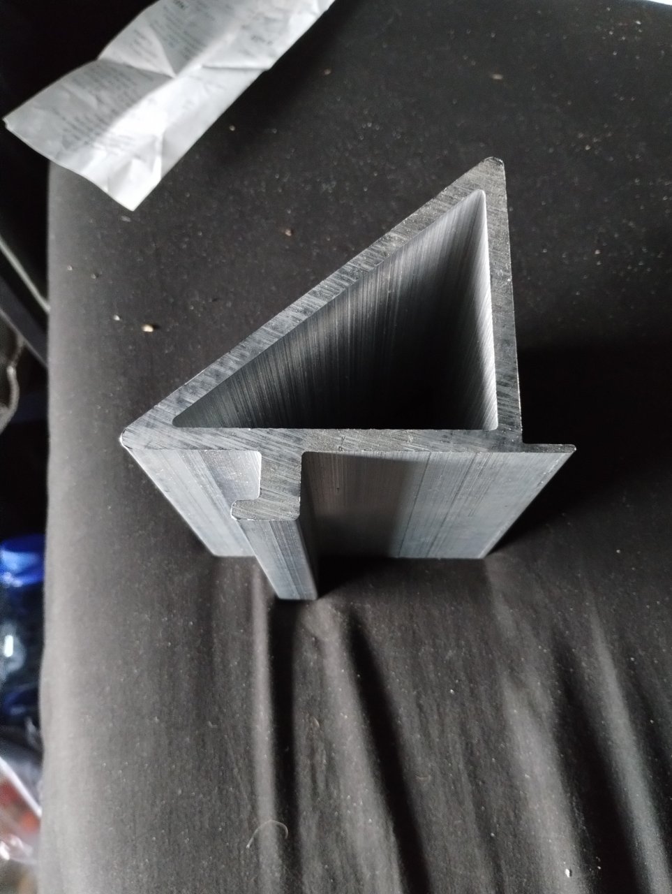

    I had 4 before, but when I took the side kit down and hauled for Menards, I put them in the side box. My door opened and I no longer had these racks. I bought four new ones and had a disagreement with my buddy regarding how many to use. He treats them as if the pair have 10,000 wll and uses as many pairs as he would regular coil racks. I thought the were 10,000 each, and I use 4 altogether. What's your take?

    I'm sorry, I meant these racks. They go in the rails on Reitnouer for shotgun only. IMG_20230201_084518529.jpg

    The concept is subjective. Some carriers have their own rules regarding the number and such. As far as I know, and could find regarding regulations, you're looking at minimum of 2, just to keep the timbers in place at each end, and that's basically their whole purpose. As with all securement, more is better as long as it's not in OOS condition. More is probably better as special k mentions. Figure whatever the coil weighs, it is pushing down and outward on beveled coil racks. Do you really want a coil weighing say 30,000 pounds being pushed down into that timber, which displaces that weight by spreading it down the timber and away from the coil to be under secured? I used to use minimum of 3, just to make sure the two ends stayed in position, but on the off chance that one or the other shifted during transport either through emergency manuevers or some such, if one of the coil racks came loose while the coil shifted, that there would be one more at least to take it's place holding the timber together.
    As far as I know, there's no federal regulation requiring a certain number, or a certain rating, but if those are rated by the manufacturer, then you should figure how much is needed at 2 minimum and refer to the manufacturer's recommendations. The interesting thing, though, is like belly wraps, rated coil bunk WLL is useless as regards aggregate WLL for holding the freight as it's more of a safety aspect, than a rated restraining tool. If they are rated, then I'd refer to the weight of the freight in the timbers and add accordingly, since that weight will be bearing down on that timber/coil rack and pushing outward. Start with 3 sets of coil racks or your J-Track version (meaning 6 total) to start and use as many as YOU feel comfortable using to keep the timber or coil in position.

    Not claiming I ever did it right, but I’d use 2 on each side sometimes I’d use three. Never had a problem. I also quite often put these blocks in the j track and use 5x5 beveled lumber. Works really good for big coils and the coil will set further inside the rack.
