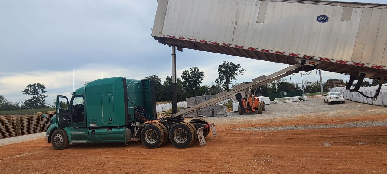

    Ah there is where the disconnect is. You are using your trucks as standard road trucks. My experince is vocational useage. I use a 579 as well with an MX13 but its tuned for power and pulling with most of the economy features discarded just due to what my useage requires.
    Im a rock truck so i have my speed governer shut off entirely as well as most of the idle shutdown and rpm limits turned off paired with a higher gear rateing then you likely use. With my engine set up in this manner its quite simular mpg wise to an X15 in a simular truck (T680 is what i used) and as i am paid by weight none of my loads are under 79k gross....ever. In a van or reffer truck i have no experince to say.
    So i will say the same to you that i disagree with your own experinces from my point of view. Then again as i also said the way i use my truck is likely quite a bit diffrent then your own.
    Doing this kind of work murders a MX in mpg. Still better then a kitty though :p and dont say its sloppy maintaince. I have a recipt book 6 inches thick and $40k in one year that disagree with THAT statment
