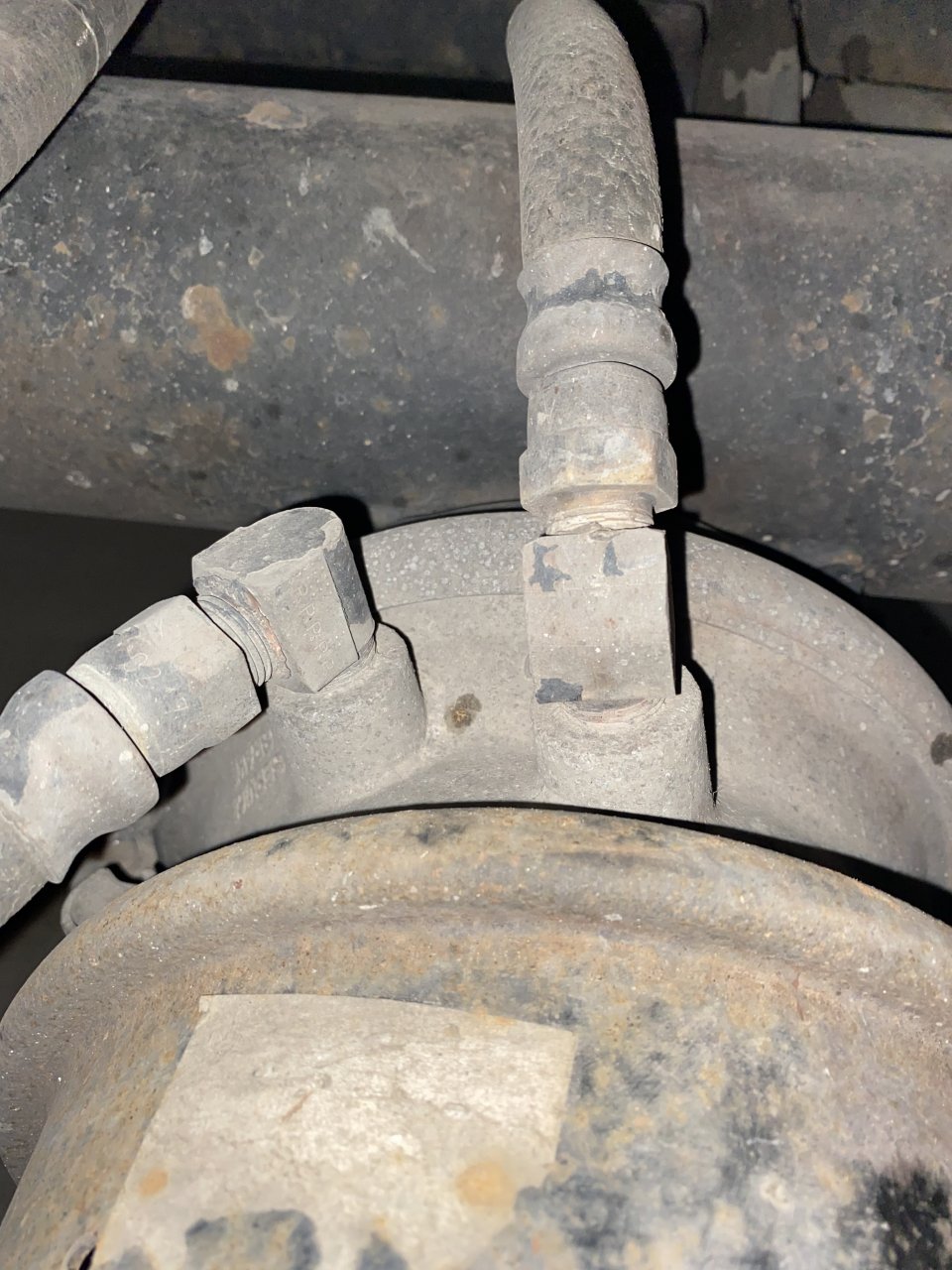

    I just bought a 2001 Great Dane trailer and I’m going to replace all brake components. The brake chambers are really old and I can’t find a part number, does anyone know which chambers or how to id the ones on my trailer??

    2001 should be Mr common standard 30/30.
    If they have square bosses where the air lines go in they are long stroke 30/30.

    Are the standard 30/30 round?

    Yup

    Trailers are usually short stroke. Any new chamber will do the job. Good luck with unscrewing the lines)

    So these are the standard 30/30 correct? I attached a pic

    AFAIK there are no other chambers used on any heavy duty commercial wagons.

    Looks like a standard 30/30 Bendix chamber in the picture.
