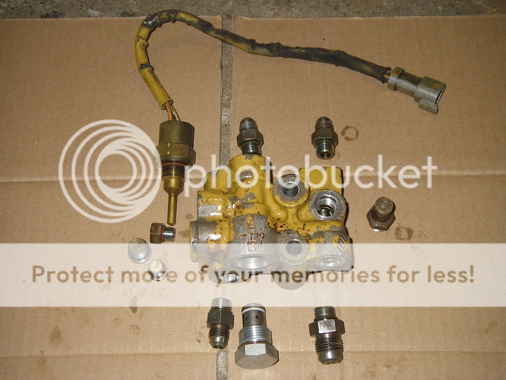

    My 97 6TS came with that block:

    Thank you Luwi67, I'm going to order or buy it from a junk yard so I can do away with the original secondary, I know it may not provide any improvement, but I will make me feel better knowing that fuel will flow with the lowest restriction ever.
