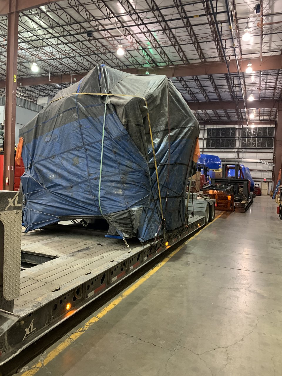

    They're a royal pain, but sometimes ya need them.

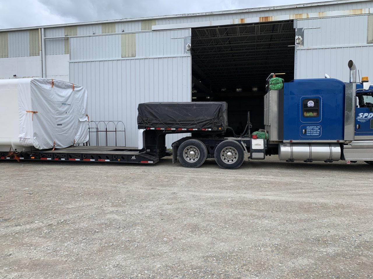

    28x28 with flap and never enough D rings cover most everything I haul. 18x20 and a smoke tarp cover the little stuff. 20220728_091736.jpg

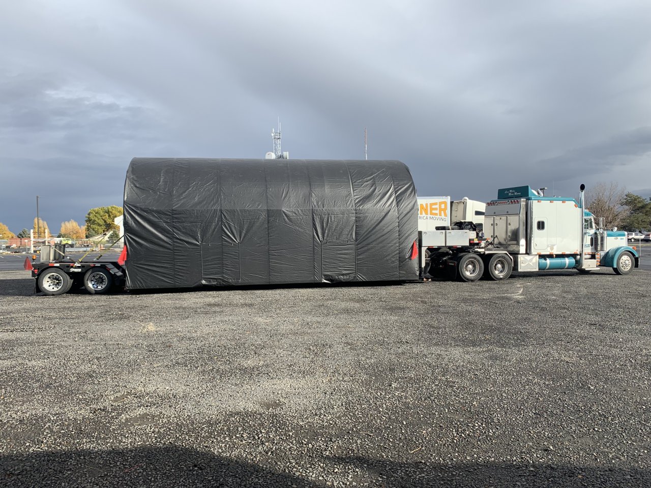

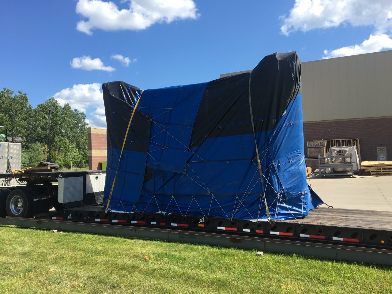

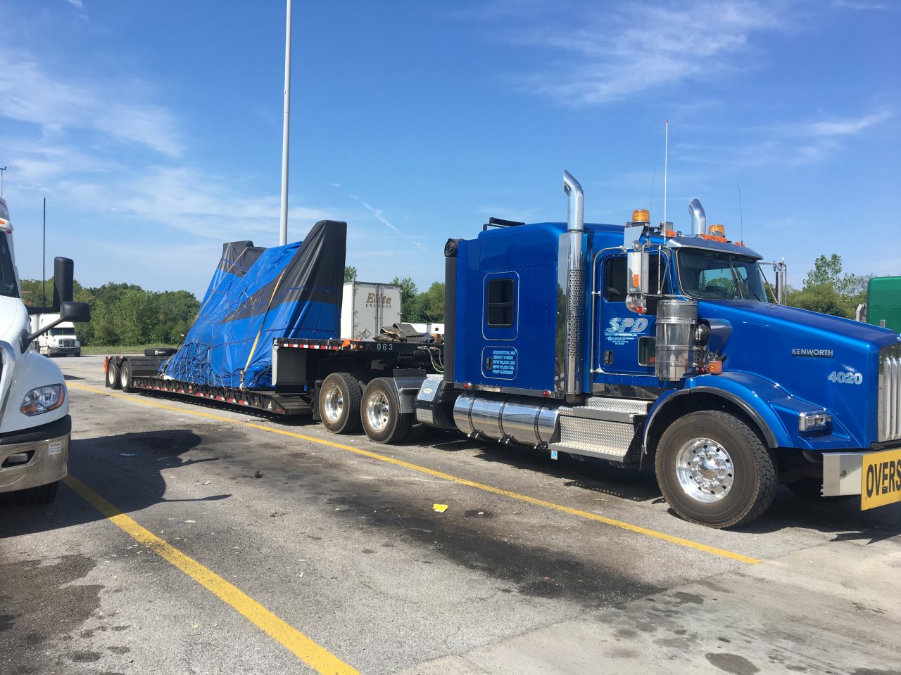

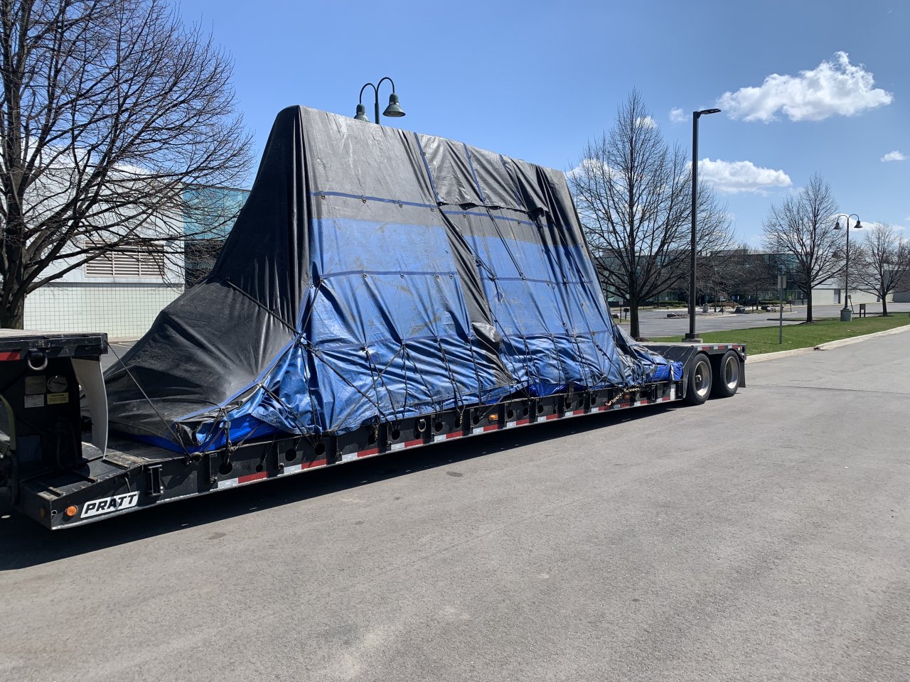

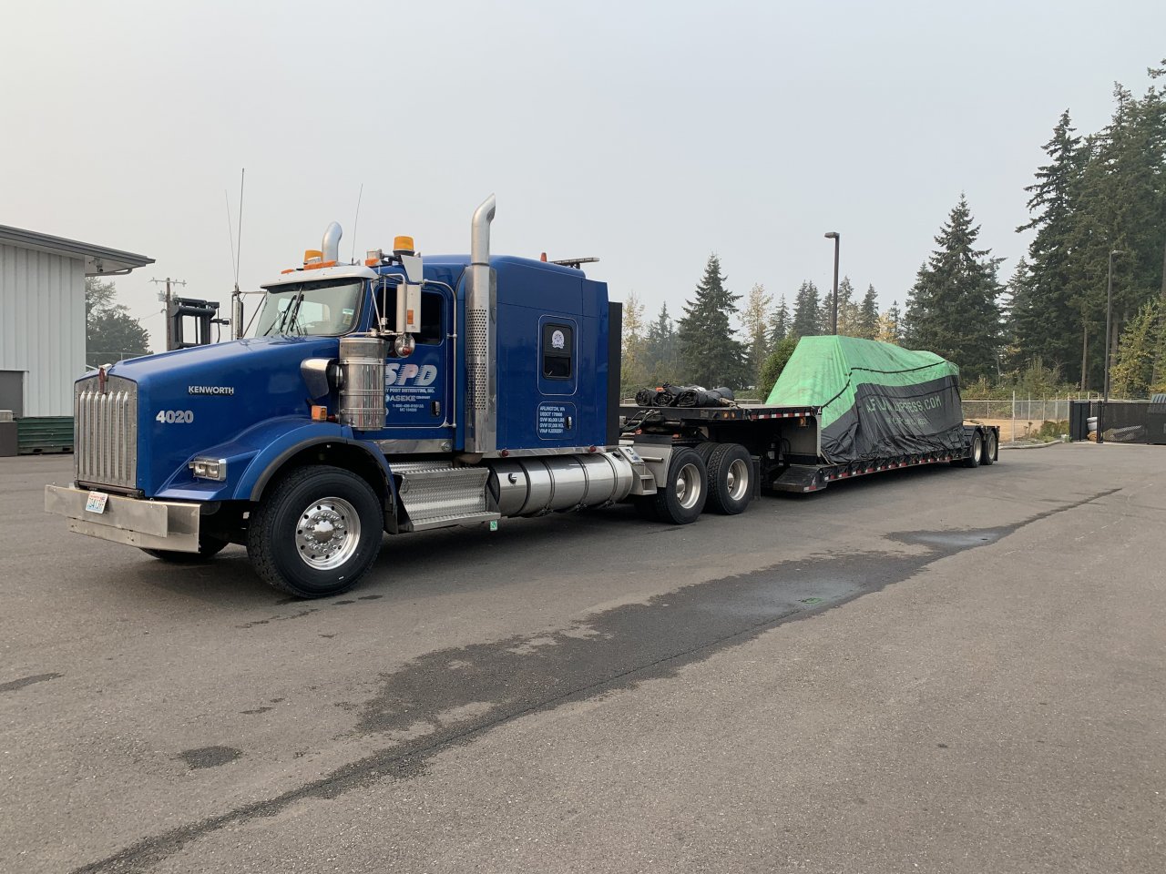

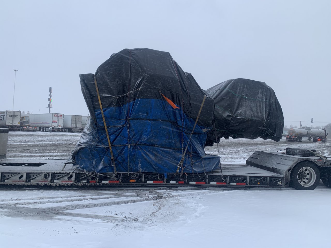

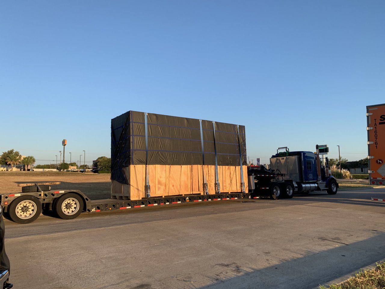

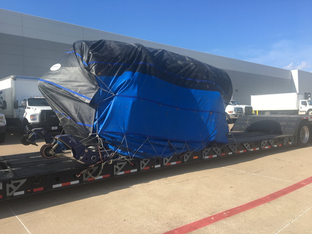

    Tarping a double drop? Ridiculous! Preposterous! Unheard of! 225406C8-EE19-46FE-A49D-4B421D75EBD6.jpeg That was tarpped at one point 87531FA1-4E49-4BB6-89F2-1E84889E6660.jpeg 39AB815C-6C2E-4A51-B3F3-9D48A1CB429C.jpeg 9336B6B5-A485-4E84-820C-93D2B17FA0CB.jpeg 4592A698-BC4A-4E95-AEAE-072F56EA5E8A.jpeg A51EA3EE-3673-4BD1-82AE-16399C6BF451.jpeg 49A8ECD4-5A80-46D4-8326-3586FBA42F7F.jpeg 18F70E2E-B7C2-4118-A148-29B945063961.jpeg C01EAD7C-03C9-4A73-9F7E-B5BC36787E28.jpeg 753BA930-A01B-4D5F-9BFA-5240C1CD4AE9.jpeg

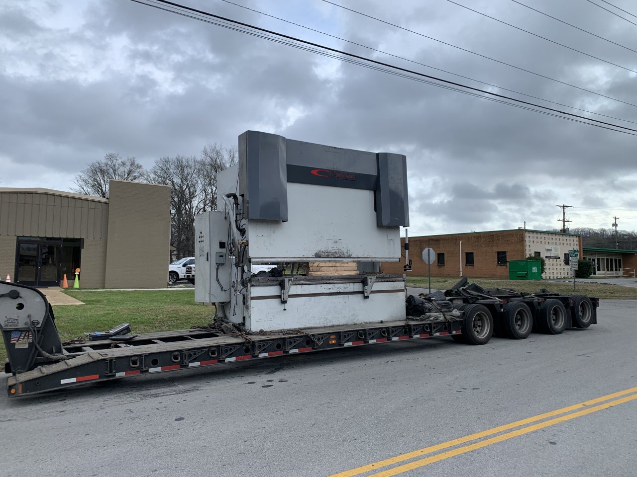

    I don’t carry tarps, but customer does 4B1FDD86-B80F-45BC-9D3F-7292BB1CB8E7.jpeg
