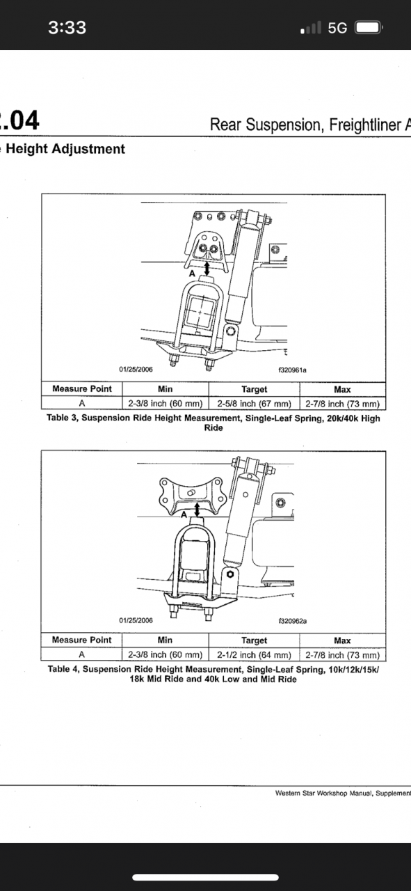

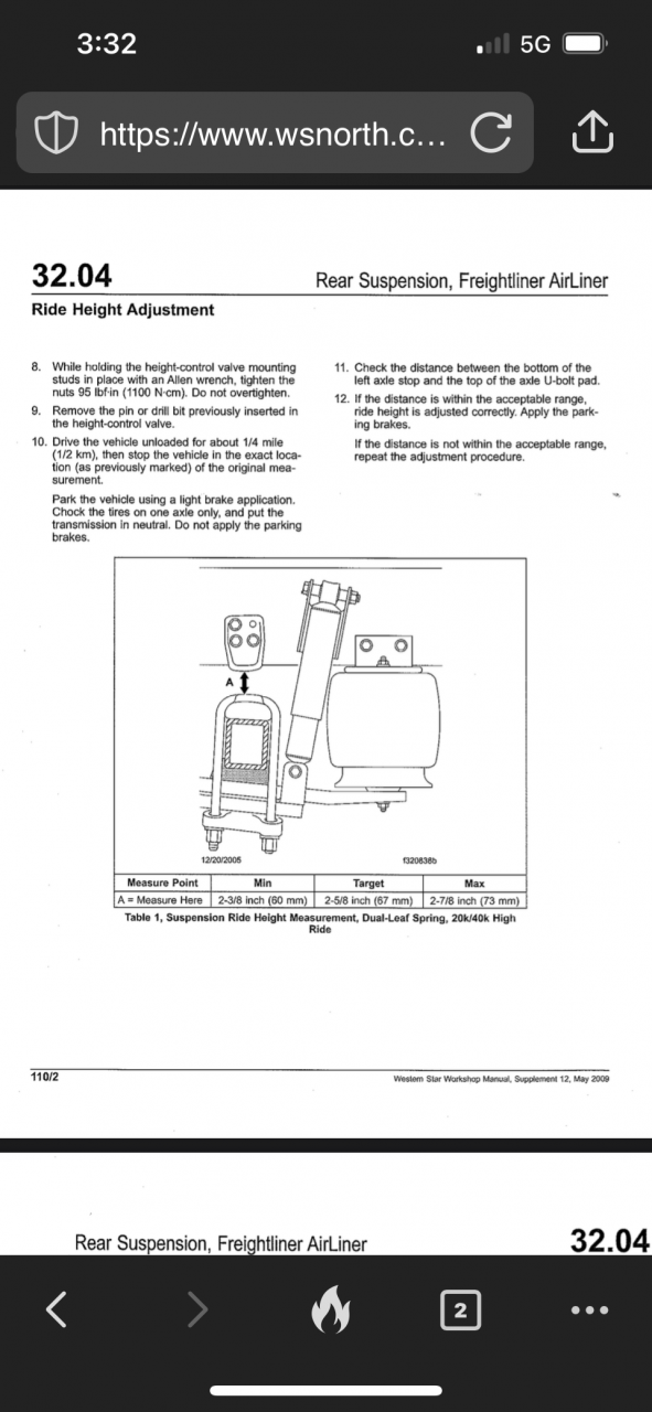

    Getting vibration unde cab. Change leveler early this summer already. Noticed vibration last few months. Wanna start there.

    If you can't find that actual measurement, try 2" showing on the bell. Most trucks I've driven it seems that's where the bags run, with some a touch higher, say an inch. At least that gives you a ball park to see where you're at.

    Google will give you the answer.
    C5999956-E13A-420A-A304-2FF54A02A02C.png 3F85E180-0E98-478B-9CAE-617233D0ABA2.png B52202DC-DD39-4D24-B96F-532F7F4D0A93.png
