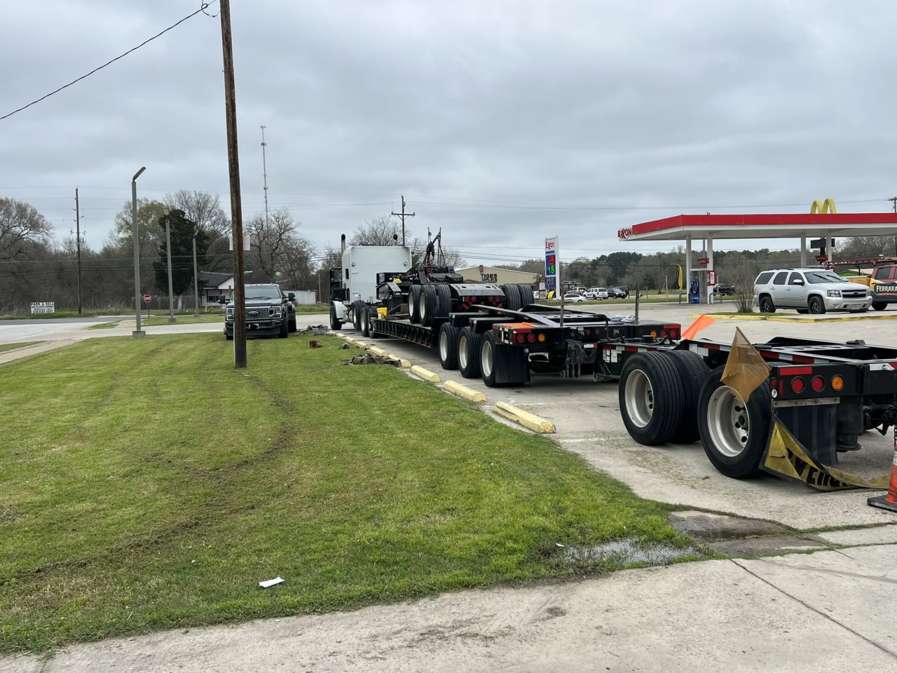

    In above pictures you can see the rollers I was referencing ( the deck is disconnected)
    the pivot and the booster connection
    Tug Toy Thanks this.

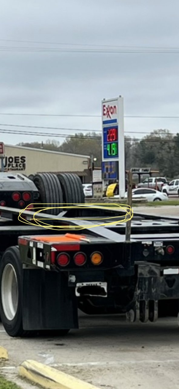

    This pic that has the area circled. There is a pin inside there. One in each side. They are manual pins.
    I appreciate ya breaking it all down for me. I have very experienced driver that starts in 2 weeks. I just like to be familiar as well
  7. Rontonio
    Rontonio Road Train Member
    6,311
    45,983
    Aug 9, 2009
    yes that is where the travel pins would be.
