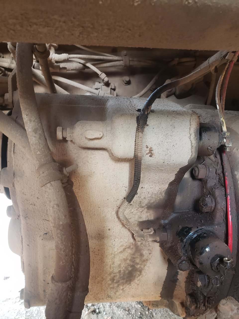

  9. richgoff
    richgoff Bobtail Member
    21
    5
    Jan 28, 2010
    richville NY
    In that pic, the bolt on the front of the actuator, is that an adjustment?
  10. Inderjit
    Inderjit Heavy Load Member
    768
    735
    Sep 17, 2017
    That bolt in front of the actuator goes in the hole where the air line connects to the actuator cylinder to push in the piston to allow the diff to be removed from the housing.
    It is stored in its present location.
