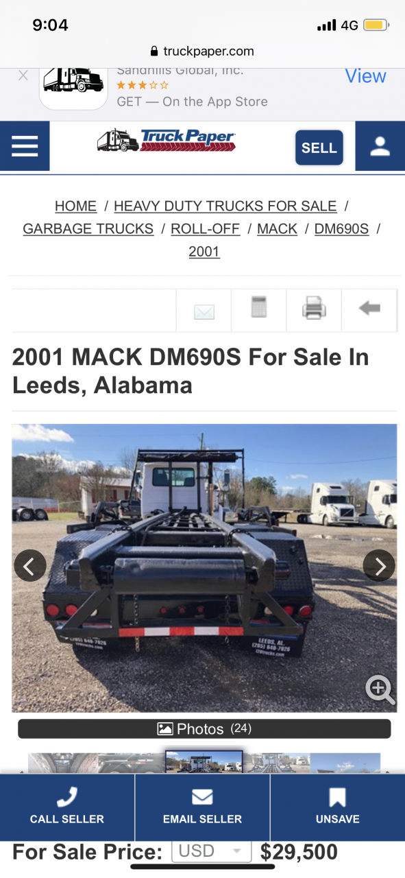

    If this is your range, unless its a hobby or are a diesel mechanic and can afford to re do the cab, stop right now and reconsider your plan. The first has a fresh coat of hide the age paint and plastic rock guards. But the interior shows its hard life. The second #### no. Tri axles are for heavy duty and it was definitely used. Not to mention bud wheels. No thanks. Nothing in that range should be used as a business launch platform.
    My opinion of course..

    Just from the interior you know it’s had a rough life because of the wear? I mean obviously trucks are going to have wear on the interior they are used trucks.
  4. street beater
    street beater Road Train Member
    4,578
    20,669
    Apr 18, 2014
    cold as hell, MN
    The mix of 700k 32k hours the 3rd axle and a almost 30 year old chassis would make me run, however, if you know what your looking at and you crawl through it and mechanically, electrically and physically (welds supports mounts rust free and look strong) and verify the claimed upkeep/repairs were done... see i still can't say id buy it. I don't care about "old iron" dont like macks to begin with, just screams costly upkeep to me.... if you add up all the "work" done, it was jacked when he got it, he rebuilt it to flip it. I also dont bet on truck flipers... will he guarantee any of the work? Dunno.. just don't like it.
    But please do not make a choice based solely on my opinion. I also won't buy a ford,.....

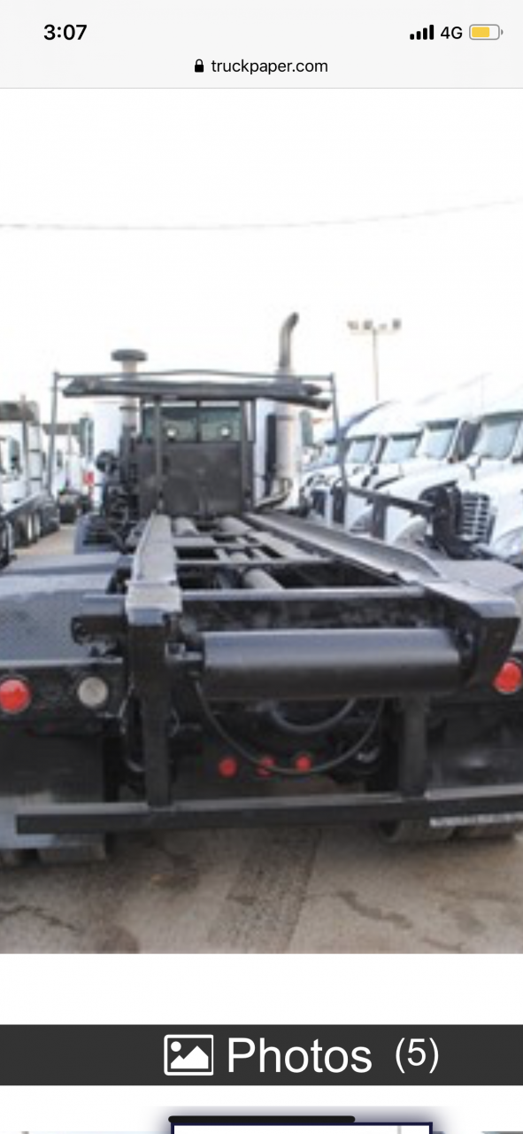

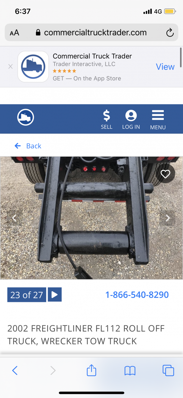

    I’ve seen trucks with rails like this and some that don’t have that edge sticking up, what’s the difference or advantages of the 2 different types?
  8. street beater
    4,578
    20,669
    Apr 18, 2014
    cold as hell, MN
    Not a great pic but it looks like a inside/outside rail truck. The width of the dumpster rails can vary depending on region. Outside would ride on the rollers attached to the outside of the rail, and inside would skid up the steel on the inside of the lip. Some areas are strictly one type. Mid west for instance expect in a few specialized areas is exclusively outside rail or deadlift. You wouldn't normally see that type of truck here.

    so you can haul 2 different types of dumpsters with It compared to one? msot of the trucks I see have rails like this. I’m not really sure what’s commonly used around here.
  10. street beater
    4,578
    20,669
    Apr 18, 2014
    cold as hell, MN
    Correct. The width of the rails on the dumpsters can be different. Sometimes its based on what type of can, self contained, packer/receiver, ect.. sometimes its the regional norm that dictates it. You could call whoever in your area makes them and ask what the normal width is of the ones they sell. If they are a bigger manufacturer chances are they make the normal type for your area.

    I got it now. Did some research and I understand the terms. In the picture above/ below. What is the piece of metal that is coming up off the rail 90degress. Dealer says it’s a outside rail truck but not sure what is attached to the rails
