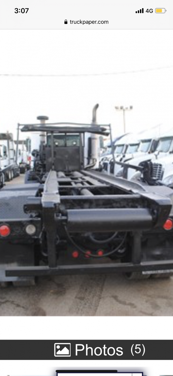

    I can't be certain about that not being a in/out vs a out only, as i have only driven a out and deadlift. However if its a out the vertical section could be to protect the rails or aid in keeping the dumpster from hopping the rail.
    Mack Rd roll off truck Galbreath hoist 300 E7 46k rears (parts) CAB/TRANS SOLD | eBay
    In this one you can see the distance between the rollers and the top of the rail. That section is where the dumpster overlaps the rail.
