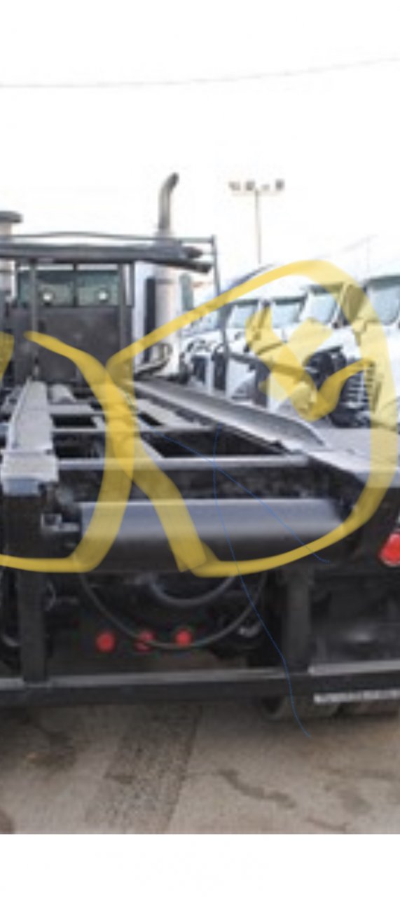

    54CC0F31-1C36-4918-96C9-530A8C342230.jpeg So I went and looked at a couple trucks that were local to me today. Dealers were closed but I did get in touch with the sales guy, and I’m just confused. All the trucks that I looked at are supposedly outside rail hoists, but they again look like the picture I’ve previously posted and make me believe they are not outside rail hoists. Sales person wasn’t very helpful and didn’t really know either. I cannot understand what those prices of steel sticking up 90 off the rail is. Is it possible they are guides of some sort? Before I go back to the 2 dealers, which are about 3.5 hours away, I need to confirm that they are indeed outside rail hoists.

    They are at least in/out if not just out. The rollers attached to the outside of the rails is where the can rides. Like I surmised earlier, either its a in/out or its a out and the vertical pieces are to assist in guiding and ensuring the can won't jump the rail.
