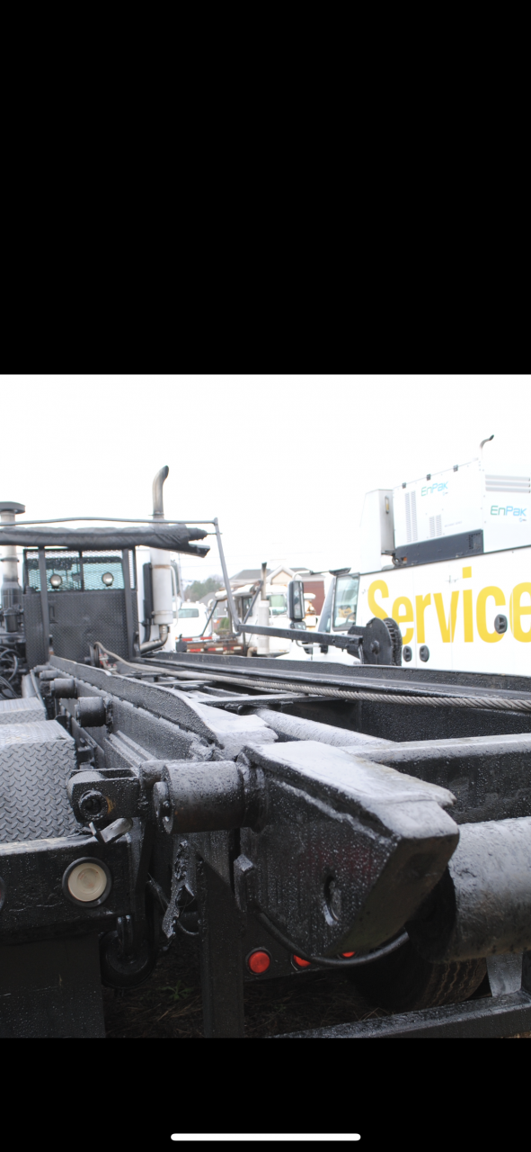

It’s just odd that most every YouTube video I see, or trucks driving down the road don’t have the vertical piece. Could it be welded on after the fact? Dealer sent me this. Looks like the vertical piece is welded on and appears to certainly be inside outside hoist?
I’m pretty sure I went w outside rail hoist -
I would say it is a in/out from the pics. The uprights look fine, if they were aftermarket they were put in by a pro.
