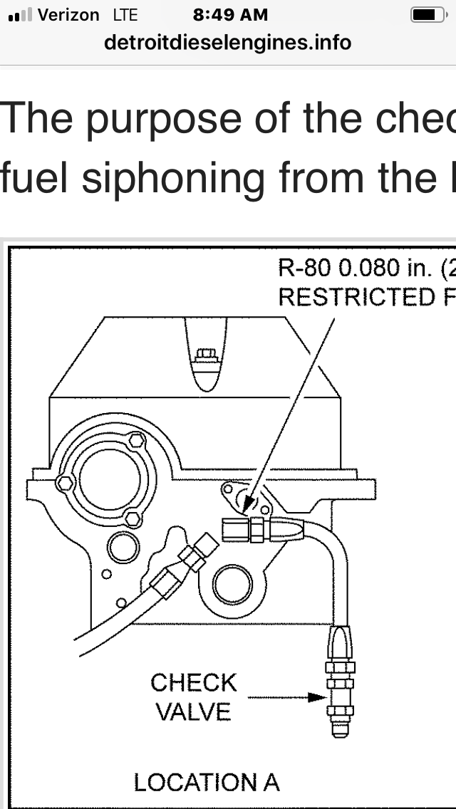

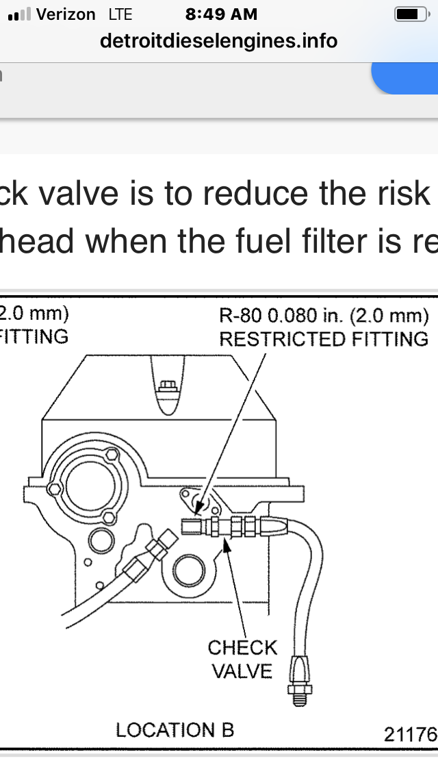

  4. Rideandrepair
    17,427
    56,532
    Aug 8, 2015
    You should have a check valve, regardless, I think the fuel pump also has one, built in. The one you added, shouldn’t be necessary, unless fuel pump check valve is bad. I don’t know enough, myself, but seems getting everything set up as it’s originally designed is a good starting point. For now and future diagnostics. I’ve heard of check valves further down line,toward tank. I know you said you don’t have one, but sounds like you do. Otherwise it would lose prime, and be hard to start. 3D27FE1F-D2DB-4B86-AFBE-F60B18EFF67E.png 1ED7C9A1-BB42-447C-959C-4EF991FD5B01.png
    spsauerland Thanks this.
  5. swaan
    swaan Road Train Member
    2,942
    4,374
    Jul 12, 2009
    BC canada
    Did you pull the restriction fitting out of the back of head and check there is nothing blocking the tiny hole????
    Sorry if you've covered this. Didnt want to read 6 pages.
    There should be a check valve in the return somewhere. Other wise you would loose prime . Has to be.

  7. spyder7723
    spyder7723 Road Train Member
    15,471
    25,076
    Mar 31, 2013
    sarasota, fl
    The factory installed restriction fitting on the return line at the back of the head is also a check valve. It has a ball and spring inside it to prevent the fuel from bleeding off when the truck is shut down. If there was no check valve in the return side the engine wouldn't start until you crank it long enough that the fuel pump can pressurize the injectors.
    AModelCat Thanks this.

  9. spyder7723
    15,471
    25,076
    Mar 31, 2013
    sarasota, fl
    The first thing I would do is pull the return fitting on the back of the head to see if it's the factory one with the check valve. If not replace it with the OEM one. It's just under 100 bucks. You don't want to use a cheap after market one because there is no way to know what pressure ir is designed for. To little pressure and the fuel bleeds off. To much leads to fuel injection problems and the truck runs like crap.
    Rideandrepair Thanks this.

  11. Rideandrepair
    17,427
    56,532
    Aug 8, 2015
    I’ve heard of problems with the shut off valve for tanks. I’ve never had a problem, but if you have new style top draw tanks, might want to check that valve. I’ve heard of putting straight T fittings in its place. Of course you can’t switch a tank off once you do that. Hate to mention it again, but are you sure Penske didn’t put a check valve at the tank? It obviously didn’t lose prime when you first bought it. The check valve you installed holds prime for the same reason a straw holds water with your finger on it. And you must lose prime when changing filters, unless it’s done fast bathe check valve you installed may be causing the high pressure in filter. Maybe even the cause of sputtering. I’d get rid of that. The fitting us separate from check valve, the fitting has ,80 mm hole. Some drill it out for faster cooler flow of fuel to gain HP. Check valve screws into fitting. Maybe fuel pump is going bad, from fighting the check valve you put in. I doubt it. They rarely go bad, but you can check it by putting a wire into the weep hole. If you can feel vibration it’s going bad.
