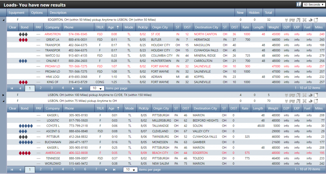

    I currently have my own operating authority, and mainly haul for the farm. Our equipment, hay, grain, etc. We do have a couple of private lumber hauls that we work in, sometime one or two a week. I am thinking of running one of my trucks a little more, just finding some regional flatbed hauls within 150-200 miles. I am going back and forth on whether I should run my own authority and pull freight from the loadboards, or if I should sign one truck on with a carrier. Looking at some of the freight rates where I plan to run, it doesn't look too difficult to gross $2500 a week running 600-800 miles. I am wanting to stay flexible, as the farm keeps me busy, so some weeks I would be able to run 4 or 5 days a week, where others I may only take a load or 2. I'm not sure if there are carriers out there that would be this flexible, this is why I am leaning towards just running the loadboards. However, all of the freight that I have ran in the past has been on our own private contracts, so I'm new to the loadboards. Any help or suggestions would be appreciated.

    I figure there's going to be a learning curve on it all. Everything that I've been looking at looks good on paper, but haven't run any of it for real, so that's yet to be determined. I'm hesitant to go with a broker because the runs that I have put together off the boards are with different brokers. I had thought of finding someone close to me to help put some loads together and book them, just until I get my feet wet. Right now, when our shipper needs a truck, they call us and we schedule it in. I haven't had to call around looking for loads.
    Example of some of the runs I have been looking at, load about 60 miles from the shop, run 210 miles loaded. Reload 45 miles away, come back 249 miles loaded. 14 miles empty back to the shop. First run pays $575, 2nd run $900. 579 miles for $1475, or $2.55 all miles. I am trying to keep my miles at $2.20 or better, I think that it will make money. If I'm missing something, please point it out.

    You're in one of the best flatbed markets in the country so you should do well. The problem running those short loads though will be time. For example the Menards DC next door to you in Holiday City will think nothing of taking 6 hours to load a truck. I got $1000 on a 200 mile last minute run for them, but they took all afternoon and into the night loading it.
    You'll need to figure out who to avoid (or charge enough to cover the loading/unloading delays) and who will load/unload in a timely manner to make this work well. Running that small of an area it won't take too long to figure it out.
