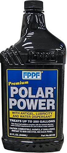

    Power Service is on sale at Napa if you don’t already have a distributor. Says monthly special so December might be it.

    I just bought 2 of those. Had some credit at the Dealer. Got some filters, etc. I didn’t realize it was Fuel Treatment. I thought it was air system conditioner. Lol. Surprised to see a low price when I checked the receipt. I plan on getting more. Only thing I’ve used for years is the little white bottle of fppf, when fueling, to disperse water. It’s gotten too expensive though, it’s just liquid ether. Also I finally dropped the bottle itself into the tank. Found a piece of it in the filter. Oops!! Tanks been shut off since. Needs to come off and get cleaned. Even if the fuels good, low tanks will have ice frost inside from condensation. Once fueled up, it’s water, and ends up in the filers. I try to keep a bottle of air line antifreeze conditioner, and always 2 or 3 bottles of rubbing alcohol in case my air lines or dryer freeze up, using the conditioner afterwards. I’ve never gelled up. Water is the real enemy. I changed both fuel filters before Parking for Christmas. Letting it sit till tomorrow, it’s warming up above freezing. It should fire right up. Using treated winterized fuel, I don’t think additives are needed. Won’t hurt, maybe help the injectors stay clean and last longer.

    Polar Power is all I knew growing up. My first real job after high school used it. They had been in business forever so I figured they had done all the trial and error over the years. Small oil company with a fleet of trucks.
    I went to check the oil the other night. Shut down for 15 minutes. Added oil and fired back up. Got that awful frozen air noise. Happened so fast. So I took care of that as well.
    Went to Napa and Tractor Supply yesterday for stuff I needed. Both places I checked fuel additive inventory out of curiosity. Napa had some. TSC had none at all.
