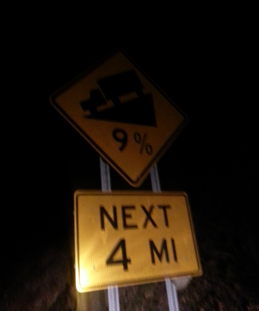

    ...A dangerous drawback!! o_O:eek:

    If you do it right even that’s manageable, barring the possible freak mechanical issue that is.
