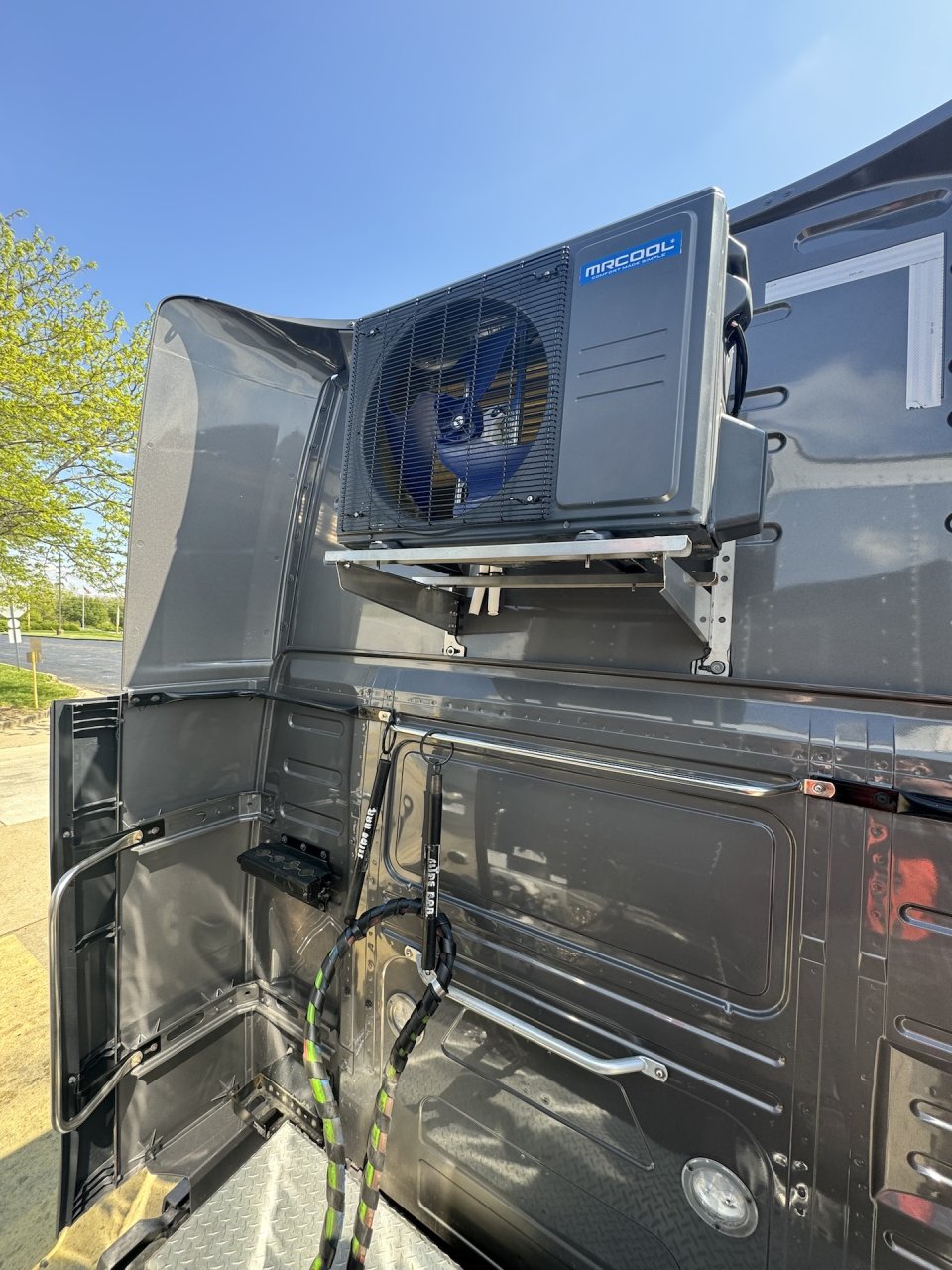

    get a split a/c system, no cutting holes in the roof,

    THIS! There's absolutely no reason these days to go with a loud, inefficient RV roof top air conditioner, even in an RV. Go with a mini split on the back wall.
    They are much more efficient. I run mine off two 280 L-ion batteries. If you need it for more than a full day/night then just power it with a Harbor Freight remote start generator. It's so simple it frustrates me to think about all the shoddy RV roof airs I had on various vehicles.
    flood, brian991219 and crackinwise Thank this.

    Where does the cold air go in and the hot air go out from???
