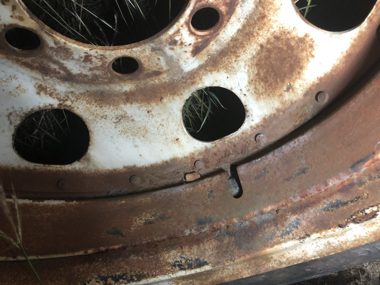

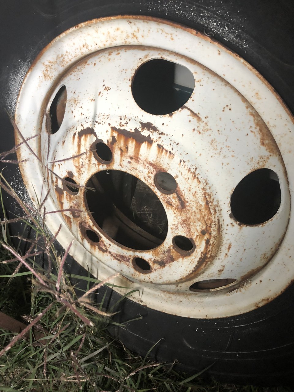

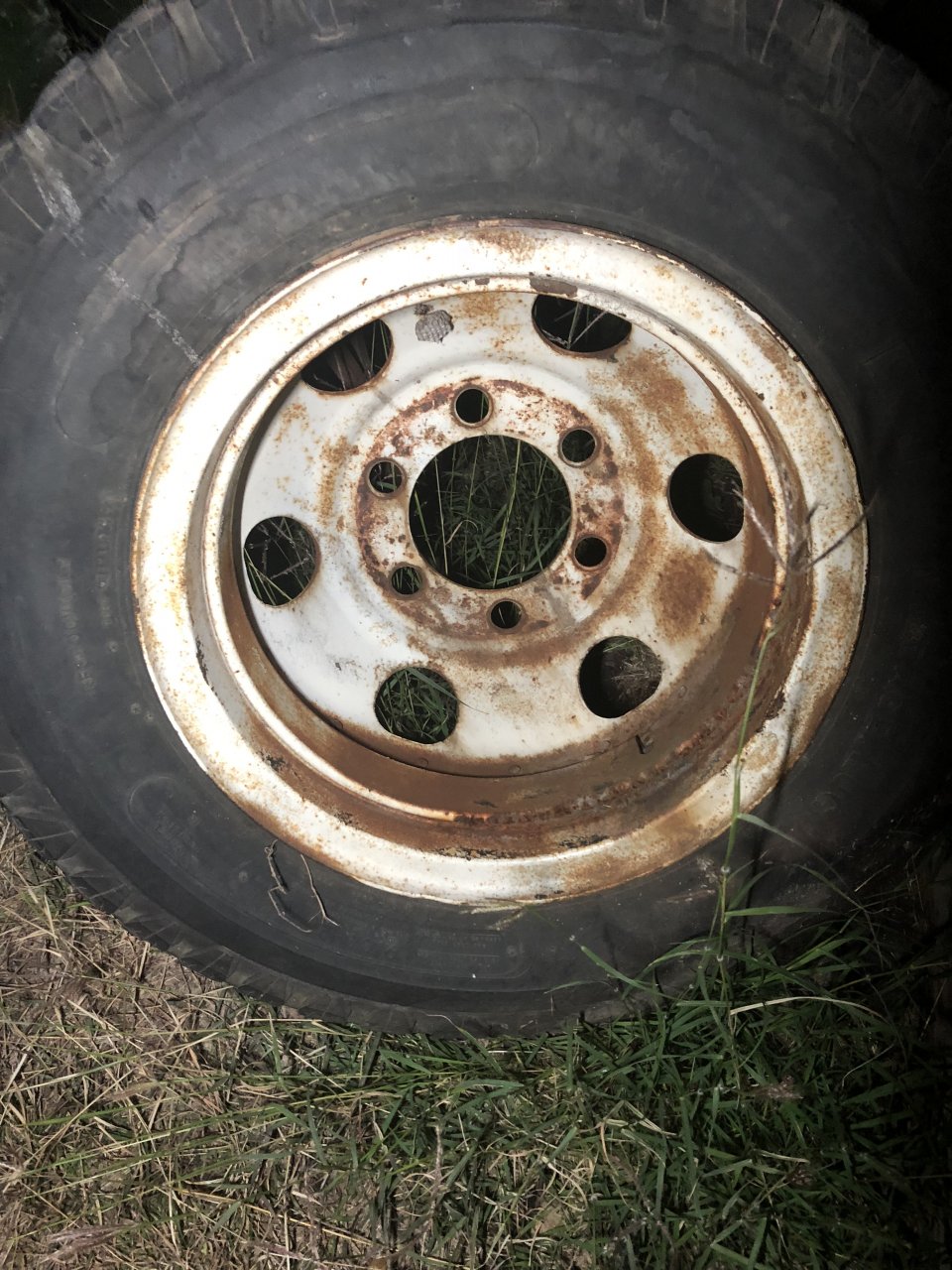

    4BA26C03-83AF-4D6A-A38C-72B5957CE417.jpeg B5D1FB94-947B-4F28-8A58-5F7EBFA0437A.jpeg
    These are the split wheel “widow makers” that everyone mistakes the split ring for.
    You can see there are two halves to the wheel that snap together in the drop center. There are no outside bead lock rings. You use the tube slot as a pry bar spot to pop them loose. They always rusted out at the tube slot rather quickly and made them impossible to safely snap back together. This one came off of an ‘65 5 ton GMC with 8.00-20’s.
