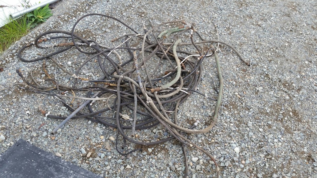

    Came out of this:
    I'm glad I decided to re-plumb and re-wire the whole truck. A pig is a pig, no matter how much lipstick you put on it.

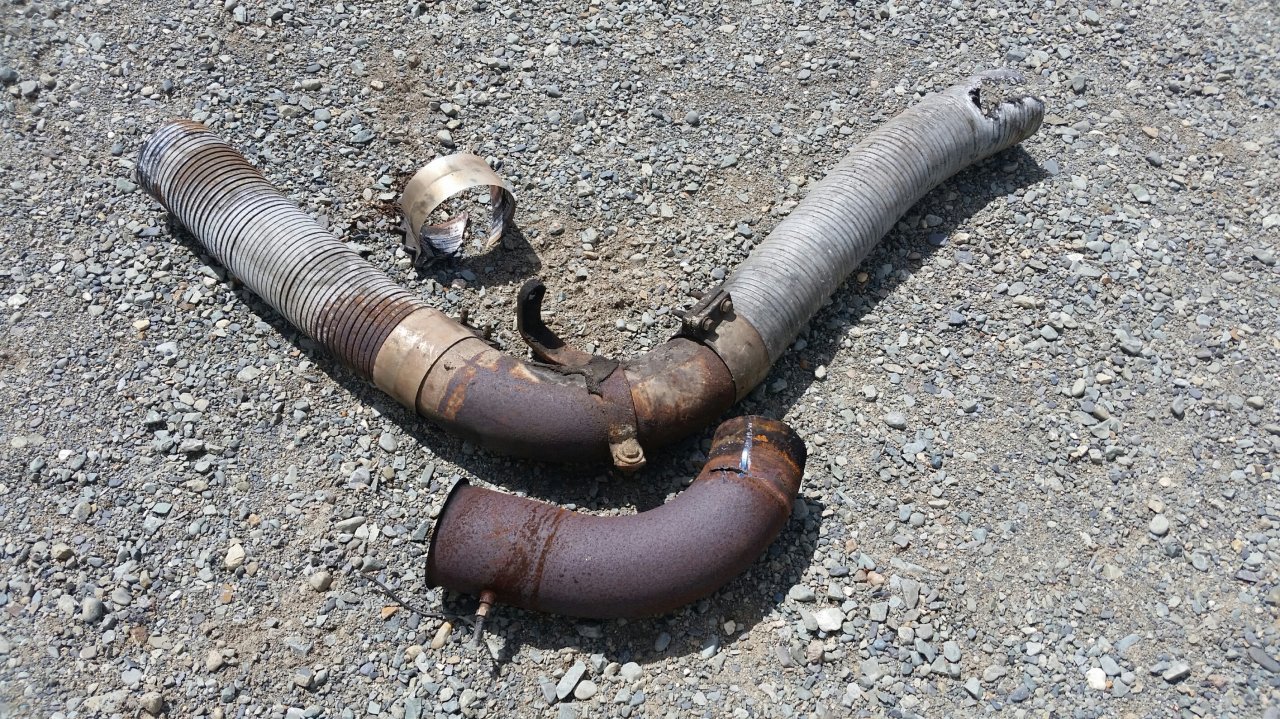

    165,486
    Didn't do too much today. Chopped off the rest of the exhaust system and pulled a couple more valves out of the dash. Then went on a wasp killing rampage after I almost stuck my hand into a nest on my 8 bag cut off.

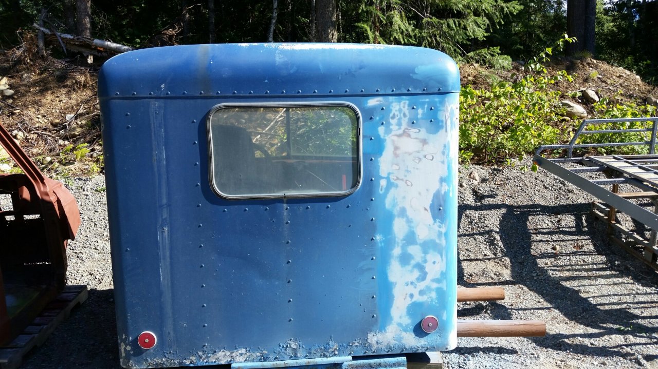

    165,486
    Started doing some sanding. Just too #### hot outside to do much more. Got all the way around to the rear of the door as well. 2016-08-15 16.11.48.jpg
