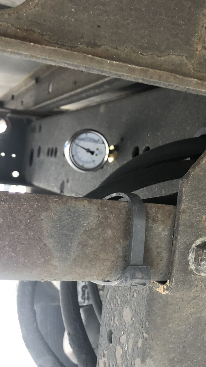

    F79ADB47-1024-4C5D-B935-38261323A515.png It’s less then $50 to do water filled guages on truck and trailer, I have tractor on my dash but I bought another pressure guage with dual needles that I am going to run another line so I have both in the cab with my new dump trailer. Water filled guage in a bulkhead fitting down by the slide controls on my fridge, I can get to within 450 pounds on it, once you have them you will never want to live without them.
    Even if I’m not overweight I still like knowing what I weigh

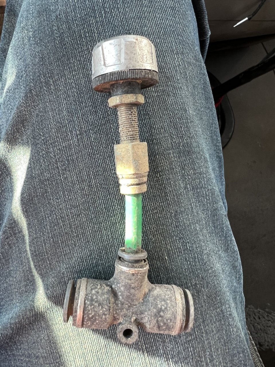

    Perfect is that a 1/4" line?

    It’s the same size as the air line that goes to the air seats.
