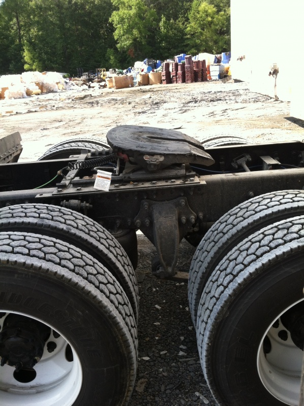

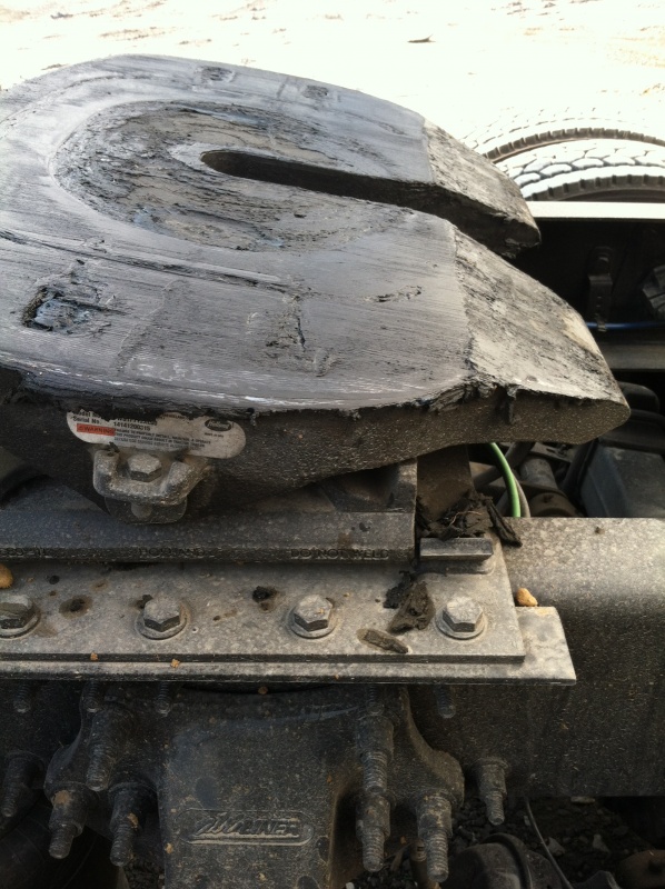

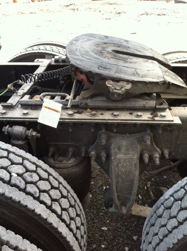

    Thanks. I re-posted the 5th wheel pics in post 47....... now they are actually pics.

    There should be minimal change in steer weight based on load where that 5th wheel is set, as it's almost on centerline of the tandem. I'm wondering if you have suspension height issues. If the airbags on the rear axle are overextended a bit, they generate slightly less force than they do within the design range. (page 25 in this link has a chart which illustrates this: http://www.firestoneip.com/site-resources/fsip/literature/pdf/AirideDG.pdf) This would result in the front axle carrying more load, and since the 5th wheel is behind the front axle, it would lever some of the weight off the steer. The same issue can happen if the suspension is too low, as the front bags would then generate more force than they should, with the same result.
    The load curve of the bags is fairly linear over a range of several inches in the center of the suspension travel, meaning all the bags are carrying equal amounts of the load. But outside that range, the effective spring rate of the bags varies and can cause these kinds of issues. I'm not guaranteeing this is your issue, but the symptoms are all there. Good Luck!

    I was refering to post 37 when i said you wouldn't make it to 12k if your fifth wheel was all the way back.
    i know i haven't been doing this trucking thing very long, but i'm pretty sure that if your trailer gets loaded heavy in the front, and your kingpin setting is far back (lets say 36" instead of 18") then you'll be heavy on your steers.. take that same load and shift it backwards a few feet in the trailer and it'll solve that issue.
    Adjusting your axle, and fifth wheel positions are the alternatives to adjusting the load. If you can't adjust the load you adjust the axles and or fifth wheel, if you can't adjust your axles, and or fifth wheel you adjust the load..
    That slide rail looks like it was positioned for a 18" or 24" kingpin setting.. it's all the way back and still ahead of center.. but if all of this just recently started happening, and nothing on the truck changed, and the kingpin settings on the trailers didn't changed, then the only viable option left is that the trailers are being loaded different
